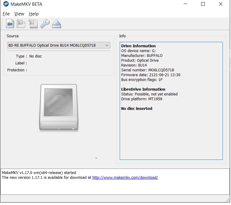

I was hoping someone could assist me in flashing my new Buffalo drive that just arrived this week. As you can see from the status screen, BU14 came installed on this drive when I purchased it.

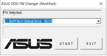

I am using the Asus modified firmware tool that was linked on this site and I am selecting "DE_Buffalo_BRUHD-PU3_BU10.bin"
And each time I receive this error. Is this happening due to encryption of the firmware? Do i need to select a different file instead? I really dont want to brick the drive.

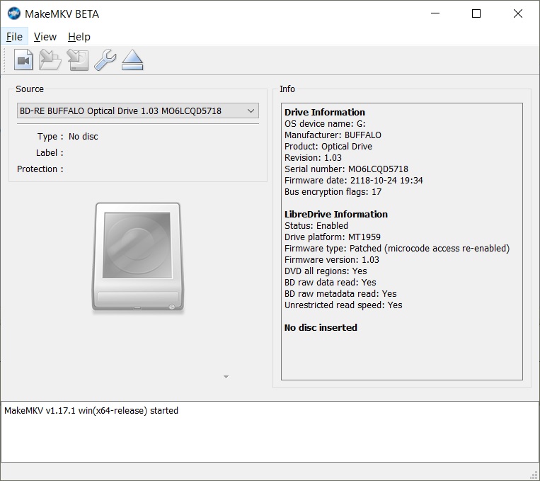

Post by paramour » Sun Aug 07, 2022 3:57 am
I believe I've fixed my own problem after continuing to troubleshoot and read other threads and found the appropriate cross referenced firmware file from the guide, which lead me to another user:
viewtopic.php?f=16&t=28254&p=122744#p122744
Looks like things are better now!
I did make a backup of the BU14 firmware in case anyone is interested in a copy, just let me know.

Use SDFtool Flasher. I think BU14 firmware might also be encrypted so if SDFtool flasher doesn't automatically apply the encrypted firmware flag, you can toggle it manually by clicking on the red "X".
Also, I don't think you can flash to BU10 directly. You should flash to BU40N BU13-MK first, then flash to BU10.

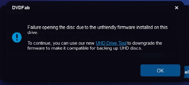

The flashing as you can see from my previous post went ok, I went straight from BU14 to BU10 and the result posted in the screenshot in my previous reply seems to indicate success to me. DVDfab is my preferred app of choice for this stuff and it still doesn't like what it's seeing on the drive with a UHD disc trying to read it. I gave MakeMKV a try also and it seemed to get a little further but ultimately failed too, with the following:

Update 2: MakeMKV worked flawlessly, after which I tried DVDfab again and continue to receive the firmware error below. I know the easy solution is to simply just use Makemkv from here on out but I'm rather glum because I had already purchased a lifetime license for fab which seems useless now. Is it looking for a different firmware version? I haven't changed anything since my previous post successfully flashing to 1.03/BU10 in the above screenshot.
Update 3: So I used the modified Asus utility from the site links to flash the drive again using DE_Buffalo_BRUHD-PU3_BU10 and even tried DE_LG_BU40N_1.00. Both were successful, Makemkv works with all of them so far, yet DVDfab doesn't like any of these firmware versions and keeps giving me the same error. I even double-checked on their web page here and it claims it will work with these versions.

DVDFab sucks balls but it should work with both BU10 and 1.00. You could use MakeMKV for UHD and DVDFab for everything else with another drive.

yeah dvdfab drive detection sucks in the buffalo case you need BU10 1.00 wont work i told them about it so they banned me good community support
and i did it in a nice was asking if they could add 1.00 support for the buffalo case response banned you are to smart might hurt our tool sales

Still no luck with DVDfab, I'm of the opinion that what they do is take the images of the firmware files found here, modify them just slightly (maybe just a name change) and then their products look for that specific file that they've altered and if it isn't there, boom! you gotta purchase their drive tool.
In any case I wanted to post part of the DVDfab log where it looked for the firmware on the drive, maybe it'll be helpful to someone. I wonder if anyone here has a firmware file that DOES work with DVDfab that you could share so that others could see what it's looking for exactly.

Update: Success!! Got DVDfab working with the drive. The problem was the usb interface that Buffalo attaches to the drive itself. Ripped that off and connected it directly to a sata port and everything is working great. Hope this helps others in the future.

hmm buffalo might have made a revision to the case it used to work with BU10
that or dvdfab messed up the detection
