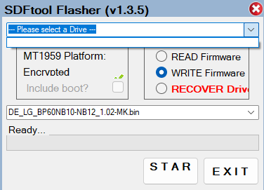

I have this same drive but when I get to SDFtool the option to select a drive won’t even allow my drive to pop up. Any tips for that? And yes I have the drive plugged into laptop and yea my files for the flash are available to choose.

Install MakeMKV in the default location.corefunctions wrote: ↑Wed Jan 15, 2025 8:03 amI have this same drive but when I get to SDFtool the option to select a drive won’t even allow my drive to pop up. Any tips for that? And yes I have the drive plugged into laptop and yea my files for the flash are available to choose.

I did install MKV on my mac but my Mac isn't able to open the SDFTool software. I tried using my friends PC to add the software. He doesn't have MKV downloaded on his PC.MartyMcNuts wrote: ↑Wed Jan 15, 2025 11:06 pmInstall MakeMKV in the default location.corefunctions wrote: ↑Wed Jan 15, 2025 8:03 amI have this same drive but when I get to SDFtool the option to select a drive won’t even allow my drive to pop up. Any tips for that? And yes I have the drive plugged into laptop and yea my files for the flash are available to choose.

SDFTool Flasher is a Windows only frontend GUI for the MakeMKV command line. MakeMKV must be installed to use it.corefunctions wrote: ↑Fri Jan 17, 2025 6:21 pmI did install MKV on my mac but my Mac isn't able to open the SDFTool software. I tried using my friends PC to add the software. He doesn't have MKV downloaded on his PC.MartyMcNuts wrote: ↑Wed Jan 15, 2025 11:06 pmInstall MakeMKV in the default location.corefunctions wrote: ↑Wed Jan 15, 2025 8:03 amI have this same drive but when I get to SDFtool the option to select a drive won’t even allow my drive to pop up. Any tips for that? And yes I have the drive plugged into laptop and yea my files for the flash are available to choose.
