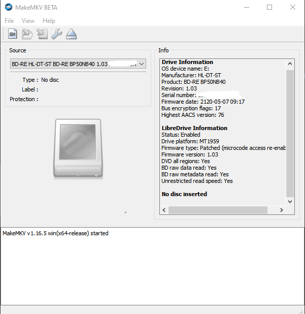

What do I do next to make it so I can rip UHD? This is my first time doing something like this
Re: Help with BP50NB40 for UHD
MakeMKV says it is as ready as it's going to be.

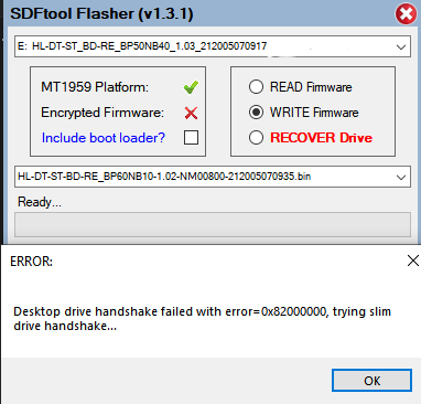

Okay I found a version from the "The all you need firmware pack" but it gives me an errorMartyMcNuts wrote: Tue Feb 08, 2022 4:56 amYou cannot rip UHD using BP50NB40 firmware. It is not capable. You now need to cross-flash it to BP60NB10 1.00-MK firmware.FatNFuri0us1 wrote: Tue Feb 08, 2022 12:58 am What do I do next to make it so I can rip UHD? This is my first time doing something like this
- Posts: 4915
I said BP60NB10 1.00-MK, not 1.02-MK.FatNFuri0us1 wrote: Tue Feb 08, 2022 9:56 pmOkay I found a version from the "The all you need firmware pack" but it gives me an errorMartyMcNuts wrote: Tue Feb 08, 2022 4:56 amYou cannot rip UHD using BP50NB40 firmware. It is not capable. You now need to cross-flash it to BP60NB10 1.00-MK firmware.FatNFuri0us1 wrote: Tue Feb 08, 2022 12:58 am What do I do next to make it so I can rip UHD? This is my first time doing something like this
Anyway, when you press OK on the handshke message does it work?
Is your drive SVC NB40, NB50 or NB52?
FatNFuri0us1
- Posts: 12
- Joined: Tue Feb 08, 2022 12:24 am
Okay so I found the 1.00 version and it did the same thing. When I press okay it flashes something but nothing changes. NB52MartyMcNuts wrote: Tue Feb 08, 2022 11:08 pmI said BP60NB10 1.00-MK, not 1.02-MK.FatNFuri0us1 wrote: Tue Feb 08, 2022 9:56 pmOkay I found a version from the "The all you need firmware pack" but it gives me an errorMartyMcNuts wrote: Tue Feb 08, 2022 4:56 am
- Posts: 4915
NB52 is the issue. It can be done just a slightly different way.FatNFuri0us1 wrote: Tue Feb 08, 2022 11:37 pmOkay so I found the 1.00 version and it did the same thing. When I press okay it flashes something but nothing changes. NB52MartyMcNuts wrote: Tue Feb 08, 2022 11:08 pmI said BP60NB10 1.00-MK, not 1.02-MK.FatNFuri0us1 wrote: Tue Feb 08, 2022 9:56 pm
1. Select the RECOVERY option in SDFtool flasher.
2. Choose the current BP50NB40 1.03-MK firmware in the popup.
3. Select the BP60NB10 firmware in the normal drop box.
4. START
If it still doesn't work, do the same again but check the "boot loader" box. Let me know how you go.
Whenever I try anything it just gives me the same errorMartyMcNuts wrote: Wed Feb 09, 2022 2:52 amNB52 is the issue. It can be done just a slightly different way.FatNFuri0us1 wrote: Tue Feb 08, 2022 11:37 pmOkay so I found the 1.00 version and it did the same thing. When I press okay it flashes something but nothing changes. NB52MartyMcNuts wrote: Tue Feb 08, 2022 11:08 pm
4. START
It's just the same error again. “Desktop drive handshake failed with error=0x82000000, trying slim drive handshake...”MartyMcNuts wrote: Wed Feb 09, 2022 9:58 pm @Astrogoth64, @FatNFuri0us1,
Here is the complete process that has worked for a BP50NB40 with SVC NB52.
1. Flash the drive to BP50NB40 1.03-MK.
2. Flash the drive again to BP50NB40 1.03-MK, this time checking the "bootloader" box.
Now for the crossflash:
3. Select the RECOVERY option and in the pop up, select the BP50NB40 1.03-MK firmware that you just flashed.
4. Select the BP60NB10 1.00-MK firmware in the normal drop box.
5. Click START
- Posts: 5837
what marty is saying should work i have done it you maybe doing a step wrong.FatNFuri0us1 wrote: Thu Feb 10, 2022 12:14 am
do you want one of my automated flashers for NB 52?
just email me for one
