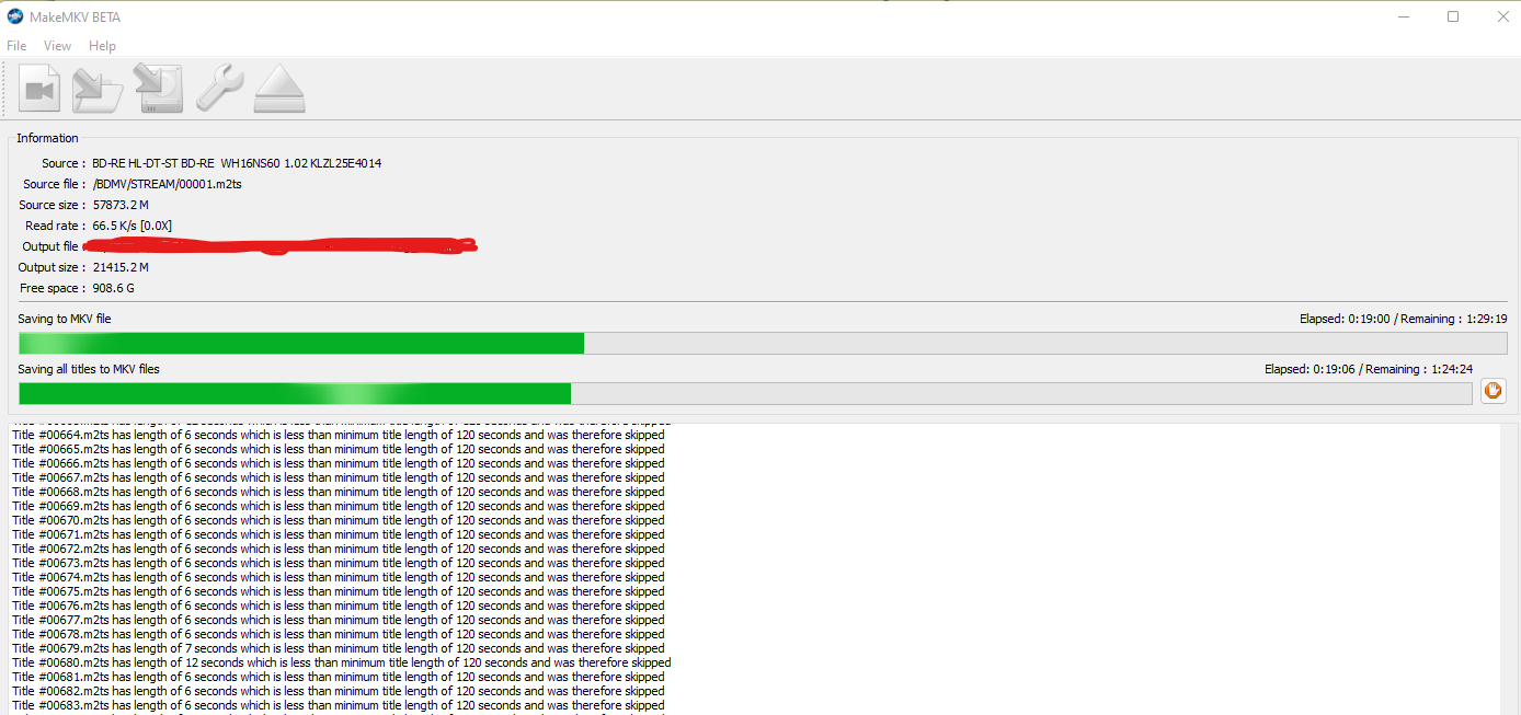

I just bought a LG WH16NS40 and successfully downgraded to 1.02MK. Everything is working fine except while ripping a UHD disc, it will stop spinning half-way and the only solution is to eject the disc. I know this is called the sleep bug and the recommended option is to downgrade to 1.01MK for MakeMKV.

Please see attached.
- Screenshot 2022-01-31 125845.png (80.52 KiB) Viewed 5304 times

Re: LG WH16NS40 - Downgraded to 1.02MK - Sleep Bug Fix to 1.01MK
First thing to try is clean the discs
Then replace them
Then if it still happens clean the laser
After that time for a BU40N
