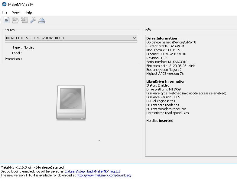

Today I went to rip a UHD disc I just bought and it didn't work. Looked good so I tried again. Keeps saying No Disc after spinning for a couple of minutes. I tried another disc I had and got same message. Tried another and same message. I saw that a new version of MakeMKV was released so upgraded to that and tried at least 8 discs and all get same message. I even rolled back/ re-installed 4.16.3.
I then tried a DVD. That worked fine. Then I tried several blu-rays and none of those work.... still says no disc after running for a couple of minutes. I tried rebooting workstation. Opening and closing drive bay... nope.
No idea what happened. I have been ripping UHD on this drive for months and no problems.... now it wont do anything but a DVD. Any help is appreciated.
This what was in the log:

- Capture.JPG (63.31 KiB) Viewed 6393 times

Re: LG WH14NS40 Stopped Reading Disc
That did it. It worked. Unplugged computer for about a minute plugged back in and it worked. Now able to rip the disc.
Thanks a lot for the insight.
