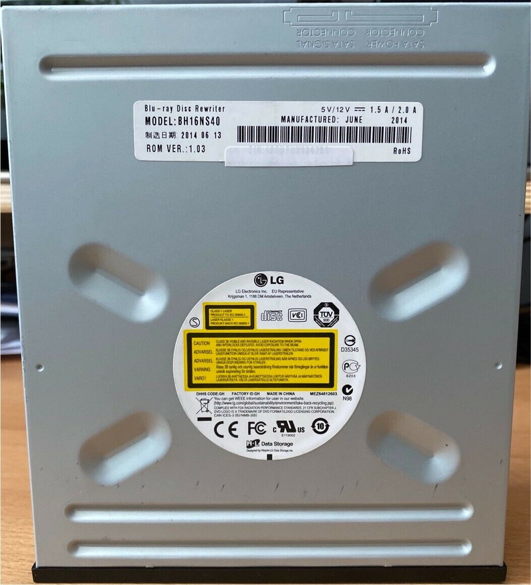

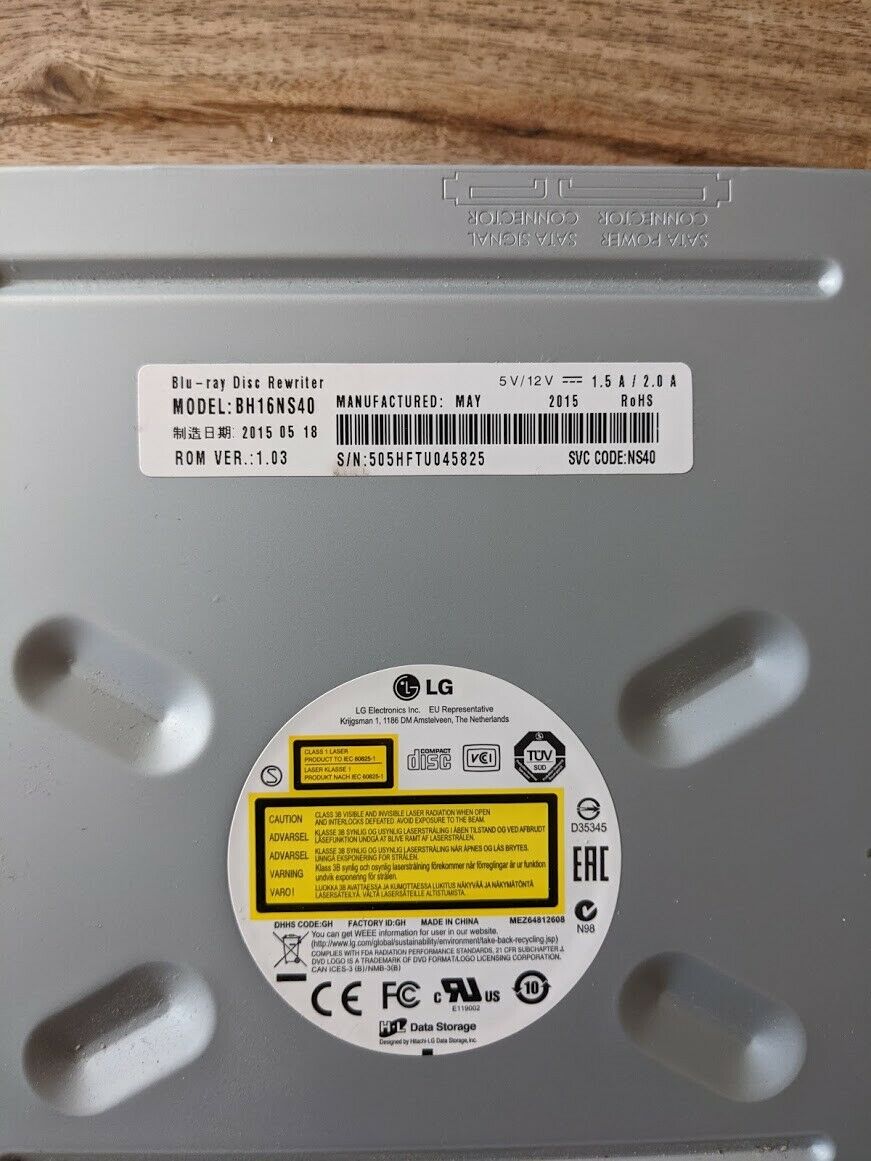

Hello all,
i could get 2 drives for an reasonable price but I'm not sure if these are flashable to UHD friendly drives.
Maybe one of you could help me :)
Posts: 10918
Re: Are these flashable for UHD friendly?
Post by Woodstock » Tue May 18, 2021 6:23 pm
Both pre-date the availability of UHD-capability, so no. The hardware won't do it.
They should already be LibreDrive capable, which gives advantages, but that doesn't make up for the lack of UHD-capable laser assemblies.

Thanks for your reply.
I thought at least the 2015 drive was capable :(

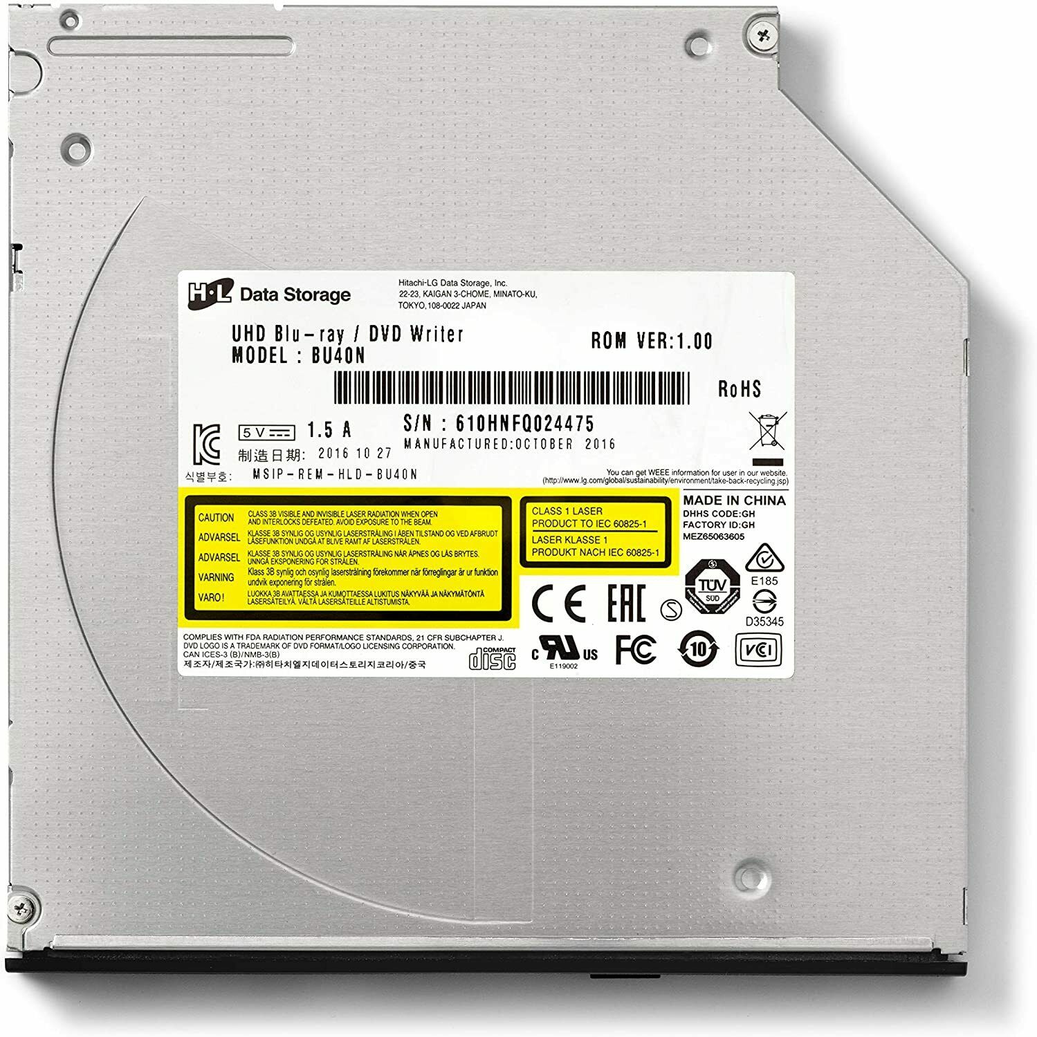

Nevertheless i would like to know is there a fw available which isn't flashable?
Is the BU40N better than the ASUS BW-16D1HT 3.01?
I got the ASUS and sometimes it is very slow and produces Read errors but my standalone UHD Player (Panasonic) plays the disc fine!
from my tests the bu40n is better than the asus.
all firmware is currently flashable

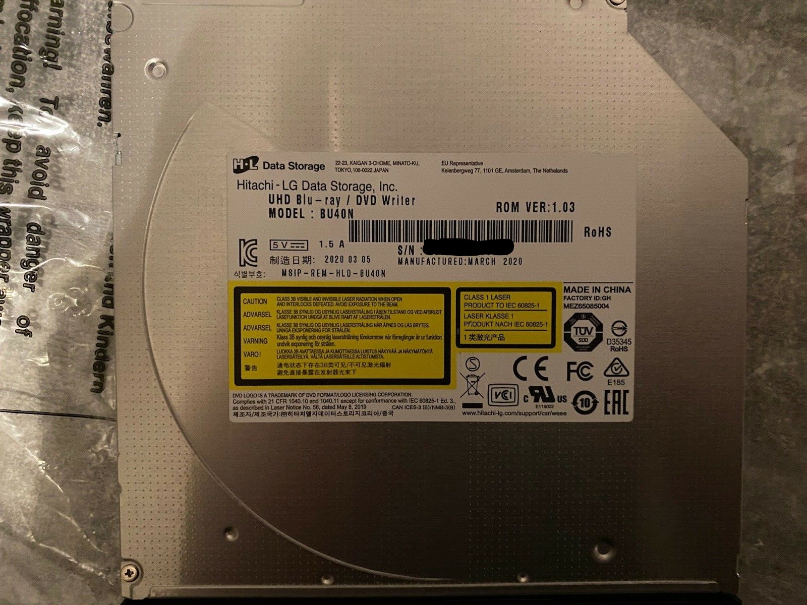

Post by Freaky69 » Wed May 19, 2021 6:48 pm
I just got the actual picture of the drive. It seems that there is the FW 1.03 installed :(
Is it okay to flash also?

Posts: 5802
Post by Billycar11 » Wed May 19, 2021 7:10 pm
Billycar11 wrote:
Wed May 19, 2021 9:31 am
But as I said your method to go directly to 1.00 de won't work
