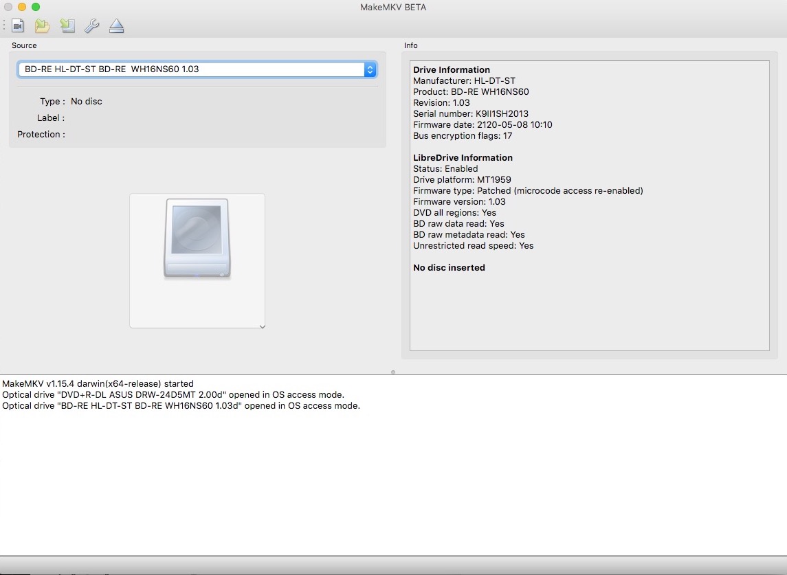

Same, tried a couple. No errors on the WH16NS60 1.03 firmware, but still doesn't see any BD disc...
Screen Shot 2021-01-16 at 7.31.24 PM.jpg (107.03 KiB) Viewed 12035 times
