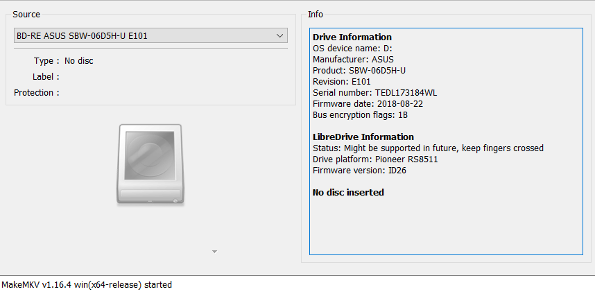

If you already have the drive, open MakeMKV with it connected, and MakeMKV will tell you if it is or can be UHD-capable. There is precedent for Asus putting different drives in the same model enclosure, and you cannot tell by the model number. When MakeMKV queries the drive hardware, though, the truth comes out.
The former can often help others.
Re: CFW for ASUS SBW-06D5H-U ?
This is the info shown in MakeMKV. Just let me know if I have to launch some other tool or look for something else.
Manufacturer: ASUS
Product: SBW-06D5H-U
Revision: E101
Serial number: TEDL173184WL
Firmware date: 2018-08-22
Status: Might be supported in future, keep fingers crossed
Firmware version: ID26
Manufacturer: ASUS
Revision: E101
- makeMKV_screenshot.png (29.79 KiB) Viewed 29336 times
The fact that the drive is a Pioneer says you're not going to be able to use it for ripping UHD disks yet.
However, it MAY be an "official" UHD drive, that can be used with PowerDVD to play UHD disks, but being built in 2018 makes that a slim possibility. Personally, I wouldn't buy PowerDVD to find out; it is a better long-term solution to get a UHD-friendly drive, if UHD is important to you.
