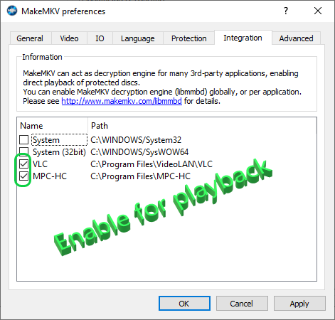

Would you try, skinning your Terminator again with the help of the Verbatim 43888 drive?
Please not only try MakeMKV's ripping ability, but also the neat playback feature.
