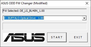

I am using the modified ASUS flasher from here
ASUS ODD FW Changer (Modified).jpg (13.24 KiB) Viewed 15151 times
Firmware versions I've tried unsuccessfully:
- DE_LG_BU40N_1.00.bin
- HL-DT-ST-BD-RE_BU40N-1.03-NM00000-211810241934.bin
- HL-DT-ST-BD-RE_BU40N-BU12-OM01001-211902230922.bin
- HL-DT-ST-BD-RE_BU40N-BN12-0M01001-211905141415.bin
- The drive itself works, I briefly played a regular Blu-ray movie.
- Disabled anti-virus software for the flashing process.
- I have tried 3 different USB 2.0 and 3.0 cables on USB 2.0 and USB 3.0 ports.
- I have tried it on 2 different Windows 10 computers (Home and Pro, both x64)
Have I missed anything? What else could I do? Upgrade to another official firmware using fwupdateroddpt_102.exe or brdrive_fwupdater_200.exe and go from there?

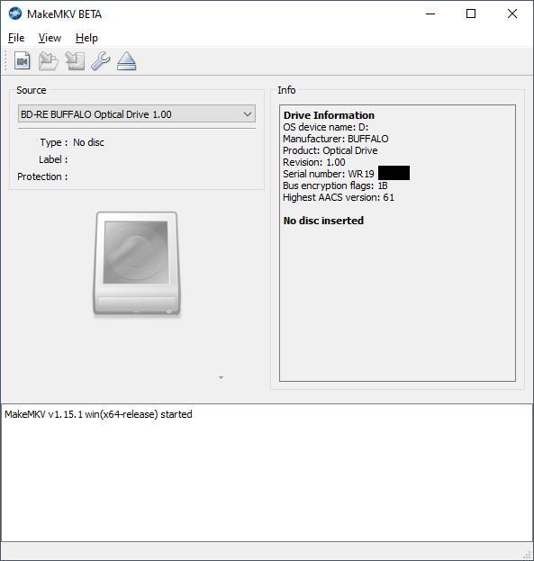

Your drive seems to be flashed successfully. Please post a screen shot of the Makemkv splash screen after startup which lists more information.

You will get better info by makemkv if you just put a regular BluRay disc in the drive. That was the recommendation you got. First things first. UHD will be the next step.
