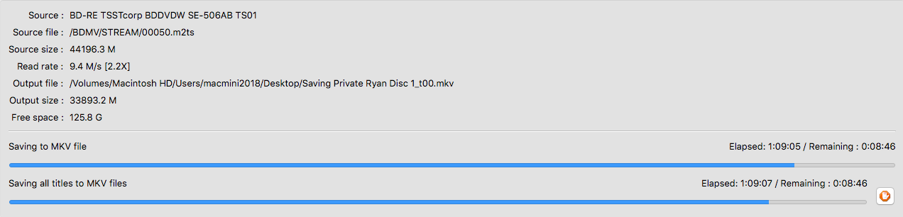

Post by stewart » Sat Mar 07, 2020 2:28 pm
Speed 2.2x, take forever!

Re: Optical BD drive that doesn't cap at 2.2x
Post by Woodstock » Sat Mar 07, 2020 2:59 pm
That is a rather old drive (last firmware update 2012). It's actually kind of fortunate that it is limiting its speed, because it would run in to power issues if it didn't - it cannot sustain full speed on just a single USB power powering it, and it would probably go off-line at about 4-5x speed, mid-rip.

It has two USB so no problem there

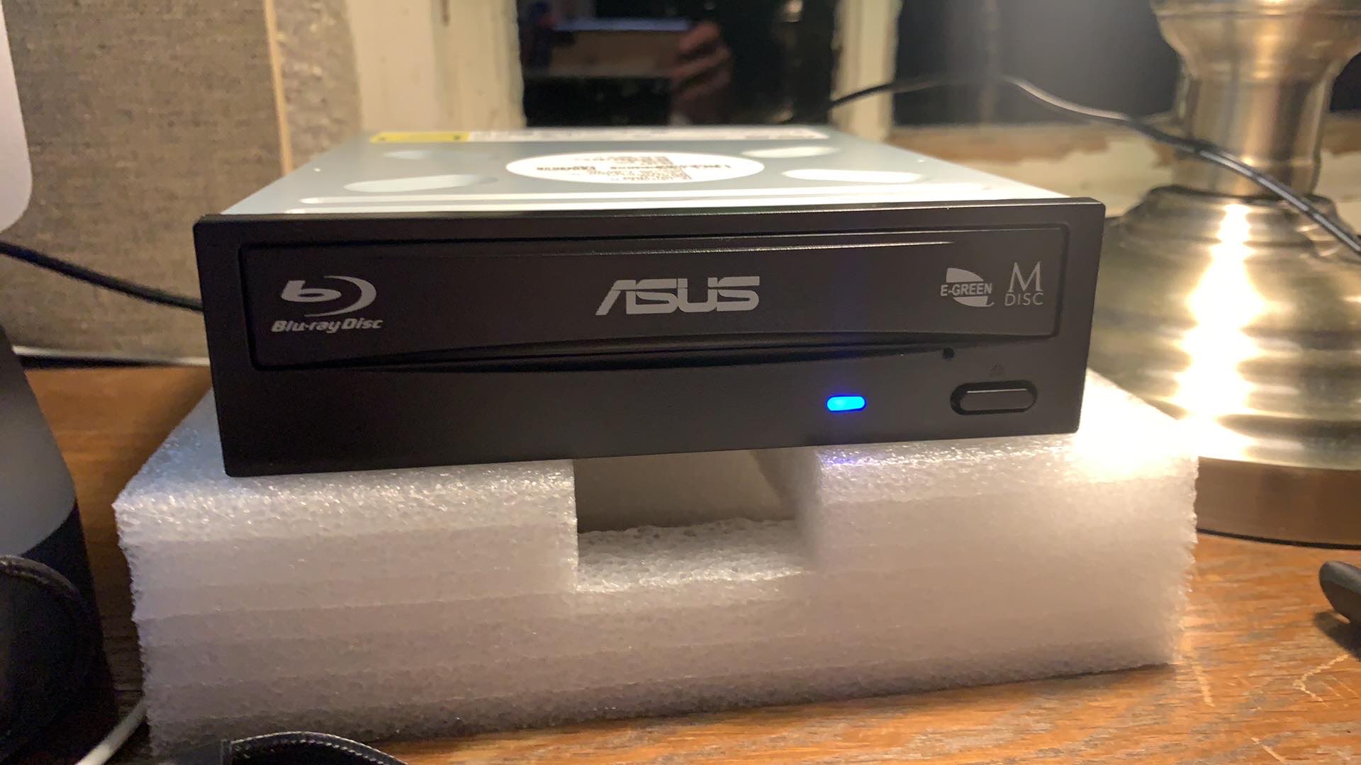

Post by Tuxon86 » Sun Mar 15, 2020 10:26 pm
I got a new Asus BW-16D1HT ( manufactured 2020-01 ) and for BR I'm getting 4.5 to 5.5x rip speed. This is with stock 3.10 firmware. I don't intend on modifying it since the speed is ok with me and I don't intend to rip UHD since my 1080p TV is not going to be replaced for a couple of years more.

Post by jonghotti » Wed Mar 18, 2020 5:41 pm
Stewart's got a drive coming that's going to fix him up once and for all :)

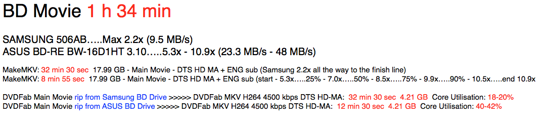

Post by stewart » Wed Mar 25, 2020 12:27 pm
Thanks to jonghotti for this fabulous drive!
Here are some numbers to compare with my old Samsung
