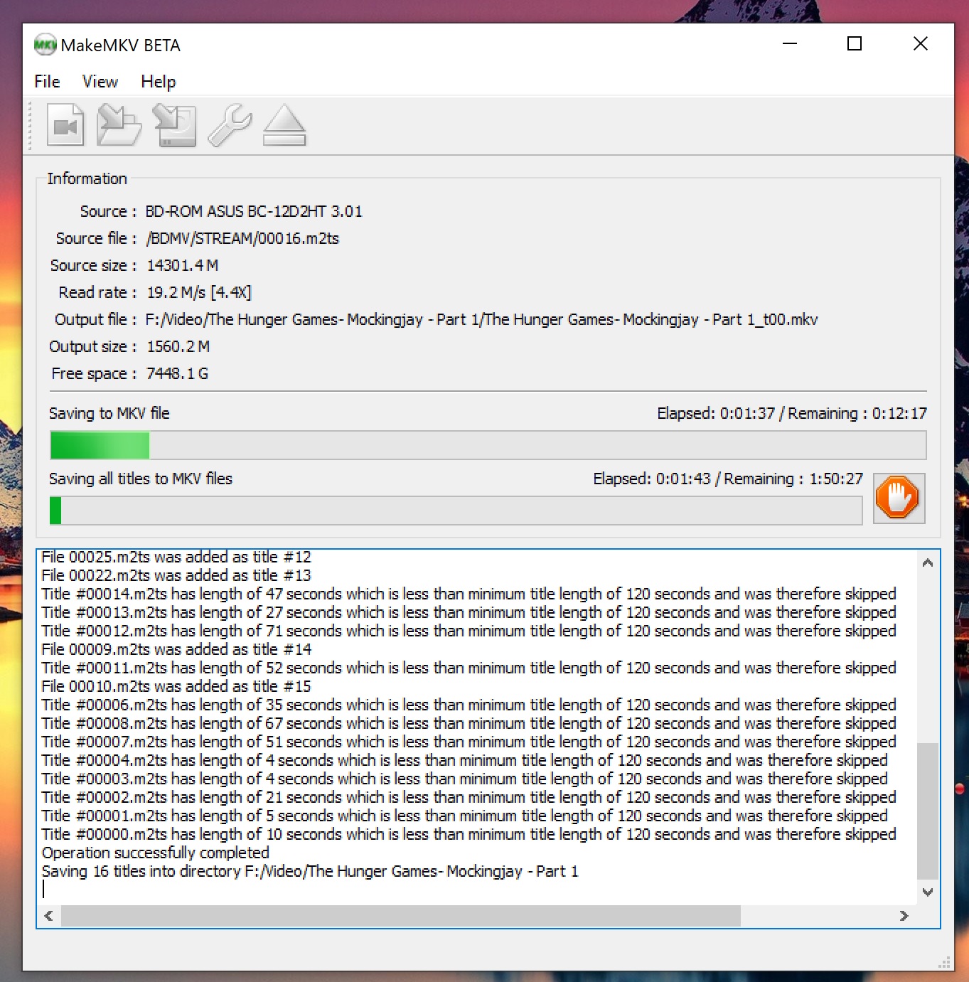

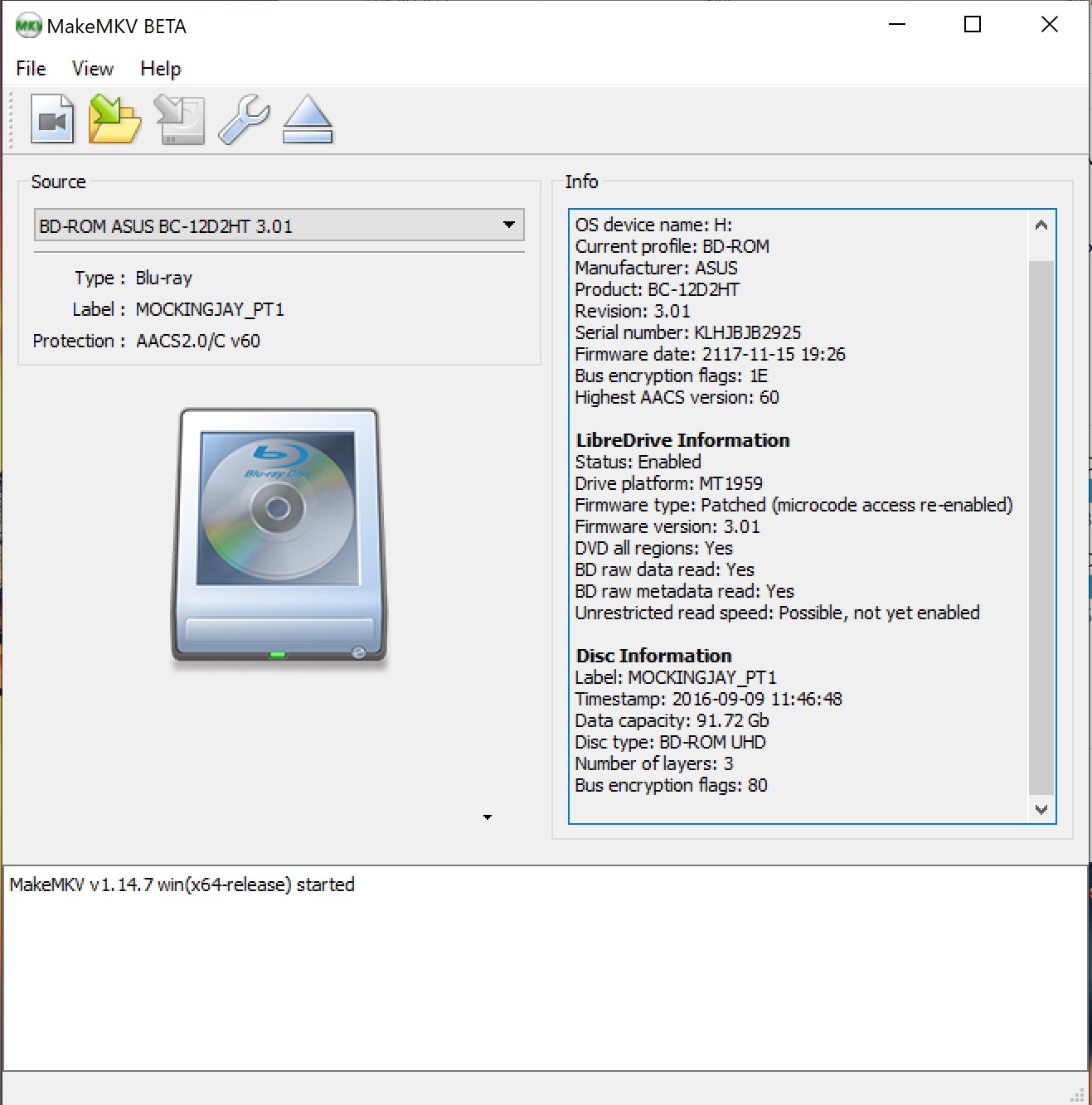

Working fine, operation full success.
- 2.jpg (596.32 KiB) Viewed 20114 times
- 1.jpg (284.44 KiB) Viewed 20114 times
