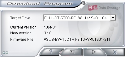

The LG WH14NS40 is a popular UHD drive that often goes on sale. There have been numerous posts related to cross flashing the firmware to the much faster LG WH16NS60 v1.00. In order to do this, it must first be cross flashed to the ASUS BW-16D1HT v3.10, or at least that is the most common procedure.

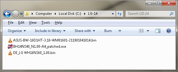

There are only 3 files that are needed, the LG flashing tool and the 2 firmware files.
The ASUS flashing tool can also be used, but I'm personnally more comfortable using the LG tool on an LG drive.
The V.2 LG flashing tool by Blackened2687 and LG WH16NS60 1.00 can be found here:

To make the process easier, I copy and pasted the three files into one folder.

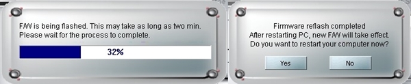

1-Open the LG Flashing Tool; you should see your LG 14 drive in the first box. At the bottom of the tool is a folder icon, click on it and choose the ASUS 3.10 Firmware from the popup window.
2-Click the arrow tab on the bottom of the tool and the new firmware will flash / install. When finished, reboot the PC.
3-Open the LG Flashing Tool, you should now see your drive as an ASUS drive with firmware 3.10. Once again click on the folder icon and choose the LG 16 1.00 firmware.
4-Run the Flashing tool as before and reboot.

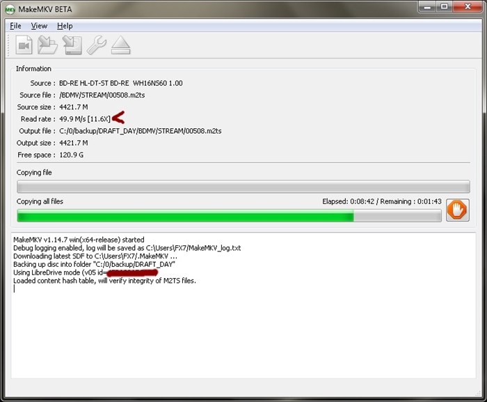

With the LG 14 Hardware and LG 16 1.00 firmware, I'm getting respectable Rip / Read speeds up to 30 M/s

I finally upgraded to an SSD and my Rip / Read speeds have jumped from 30 Mbps to 50 Mbps on a legacy sata II Mboard, really impressed with the LG drive.
