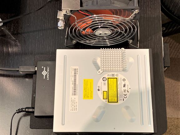

I'd like to add that I am using the WH14NS40 drive externally with a Vantec USB 3.0 Dock, Model CB-ST00U3 and it works great. My average rip speed so far with it is 2.4x which I hope will improve by keeping the drive cool. It does seem to get pretty warm otherwise. Here's a photo.
