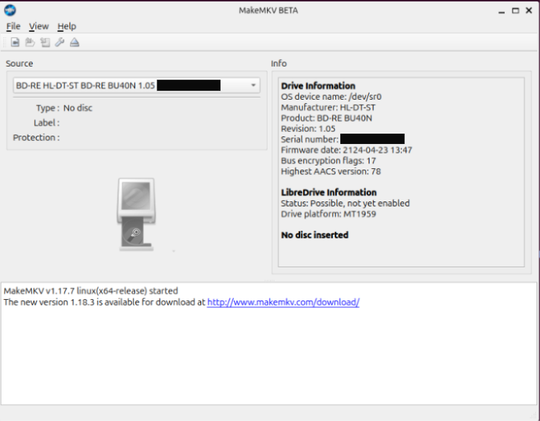

Afterwards with launching makemkv i still get the info, that the drive is on firmware v1.05, but normal blurays and dvds can be ripped now.
Screenshot from 2026-03-14 12-27-25-edited.png (131.9 KiB) Viewed 238 times
And the LibreDrive Info states "Possible, not jet enabled" (I unfortunately don't have a screenshot before flashing).

Use enc instead of main in your command line.
