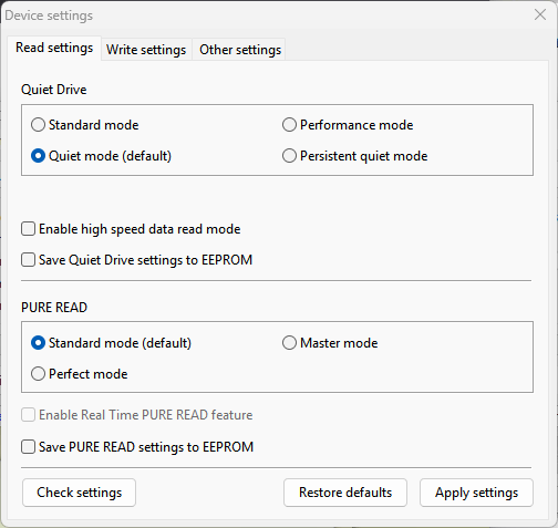

I introduced your flasher to my Buffalo drive. They seemed to hit it off! They had a little chat. It wasn't long but it must have impressed my drive because after its nap it seems to be a new person. Thank you.
Manufacturer: PIONEER
Product: BD-RW BDR-S12U
Revision: 1.02
Serial number: Herpity
Firmware date: 2022-03-07
Highest AACS version: 81
Drive platform: RS8F01
Firmware version: 1.02/ID43
Do you have any recommendations for changing the settings? Or would you just leave them alone?
Specifically I'm wondering if any of these meaningfully impact longevity or read performance/reliability.
