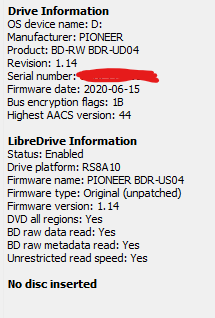

I have Verbatim 43888 with Pioneer UD04. this is makemkv shows me.
Screenshot 2025-04-18 213048.png (12.58 KiB) Viewed 4464 times
but to my problem. basically it just doesn't show me Blu Rays, just regular ones don't have and uhd ones. Makemkv shows "no disc inserted". Except out of like 10 discs and probably over 50 tries i got them to connect twice.
