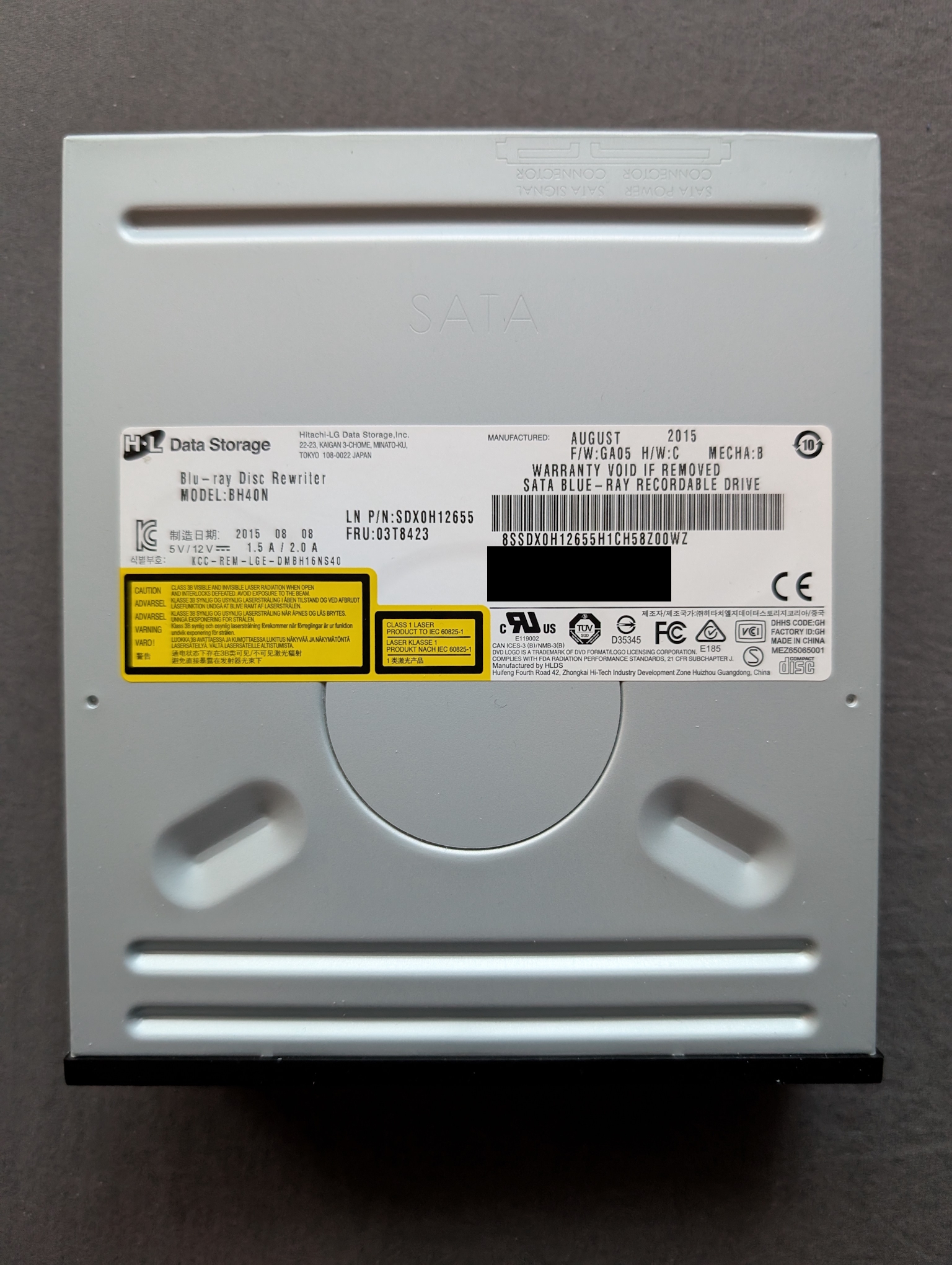

I recently bought this drive from Lenovo:
Lenovo Part Lookup
According to the sticker, it is an HL-DT-ST BD-RE BH40N.

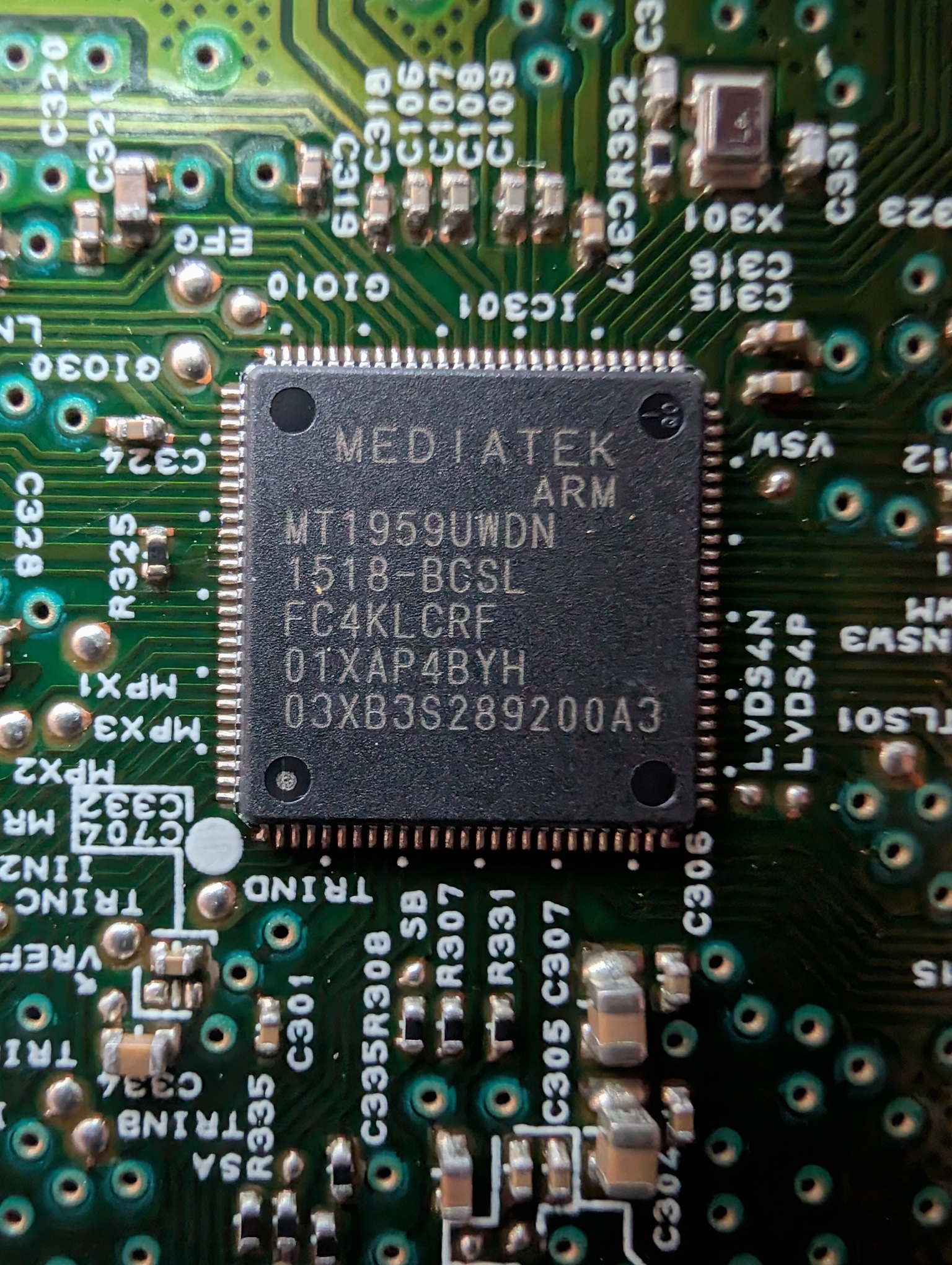

When I opened MakeMKV, it identified the chipset as MT1939.

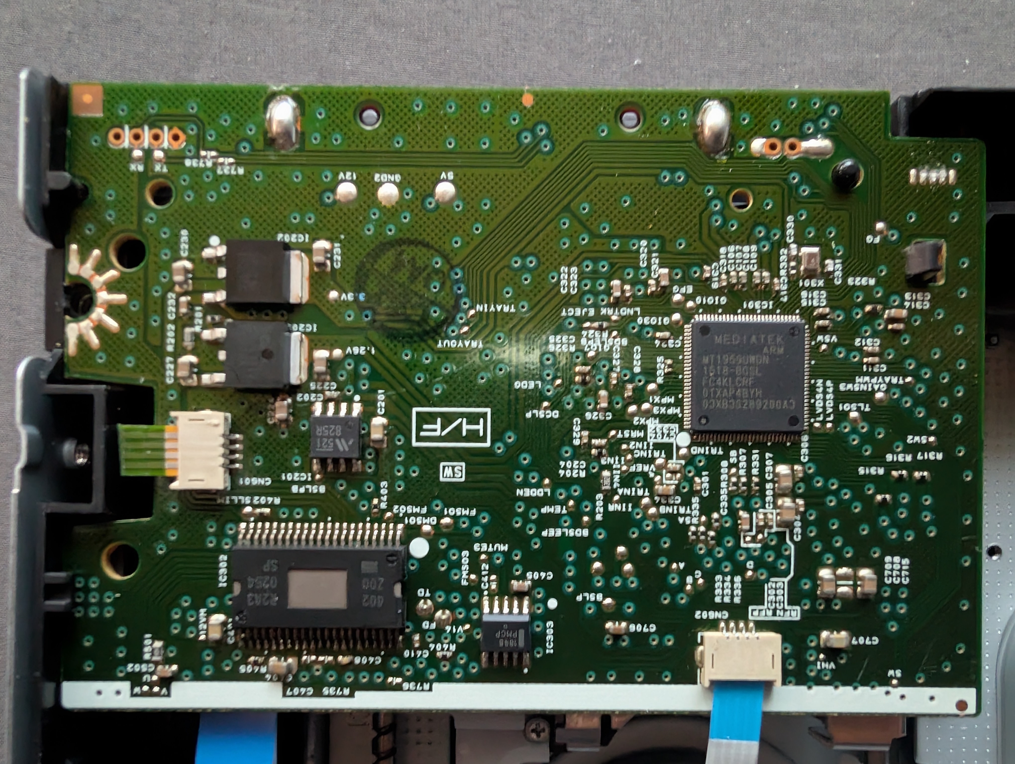

Curious, I opened up the drive and found that it actually has a MT1959UWDN chipset.
So, I attempted to flash it with the WH16NS60 firmware. The flashing process completed successfully, but now the drive no longer reads Blu-rays.

I have attached some images that might help:

You should have believed what Makemkv said. These early 1959 chips had only 1939 functionality.

You don't need the original fw just mt1939 fw
See recovery section of guide below it has links to some mt1939 fw
But your biggest issue is you need a 32 bit os and a sata controller that supports ide mode.
