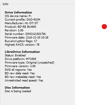

Current info from MakeMKV 1.17.6 is attached.
Screenshot 2025-01-12 110233.png (13.28 KiB) Viewed 2761 times

DVD/CD disks are read with a red LED laser, while BD/UHD are read with a blue(ish) laser. If one dies, it doesn't stop the other from working, but it makes you think weirdness is going on. "It sort-of works!"

you can always try cleaning the lasers on the BU40N its easy just eject the tray
very gently clean lasers with a lint free cloth or qtip and alcohol and dry with another do this 2 times and do not let it air dry you must remove the residue with a dry one!
