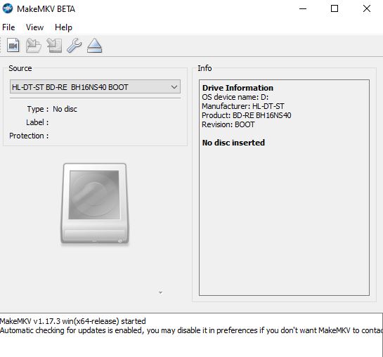

Sorry poor description there. It did work but returned an error. The drive now won’t open and MakeMkv is showing BOOT next to the drive name instead of the full drive name and the info is very limited compared to what it used to be. I’m just setting up a windows machine to try the sdftool.

Here's what MakeMKV shows.
Just got the windows machine set up.

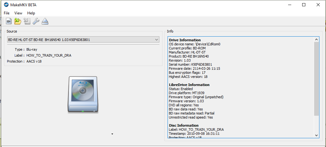

MakeMKV is now showing the below. If it rips OK I'll leave it as is. I bought it off eBay where it's been mislabled so i'll try and get my money back. Not what i was intending to buy. I already have a drive that can read blu-rays. I was looking for a new UHD drive. I had the LG BU40N previously and it was fine but the form factor annoyed me.
