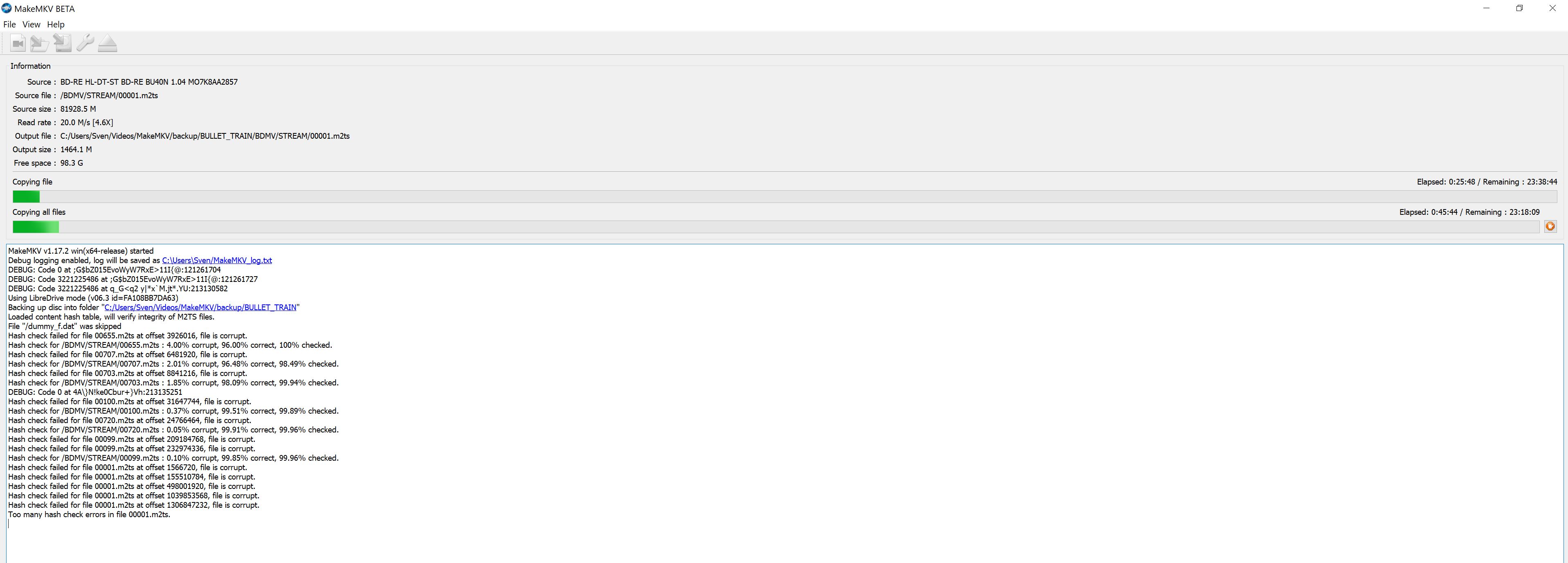

I don't want to kill the backup process to early, but it seems not like the normal behaviour, is it? See image attached. 23 hours remaining...
