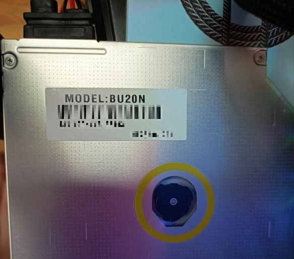

I have a backup of firmware and this maybe solves your problem. when I disassembled my BP50NB40 external case, I found that there was a model labeled BU20N.
I checked that the BU20N firmware is also available. but the BU20N models are not yet UHD friendly even if they have a mt1959 chip.

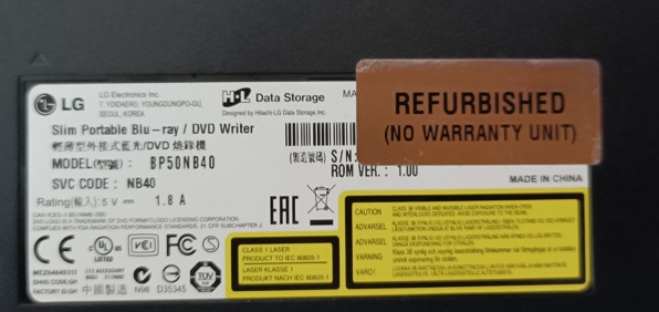

Sorry to resurrect this thread but I seem to have hit the same issue, there was a label on my drive and I did not spot the SVC Code as NB40
I have the same issue of the fact the drive will not now open and appears to be a BU20N inside so I may just be out of luck

Hi all, I know this is a old thread, but for others coming here because of a 'bricked' BP50NB40 SVC CODE: NB40 ROM VER: 1.00, due to flashing an incompatible firmware (like what I did!) and the drive does not eject, I tried a couple of things and in the end using the original firmware posted above works!

model info of my drive: BP50NB40 SVC: NB40, build date: 2015
