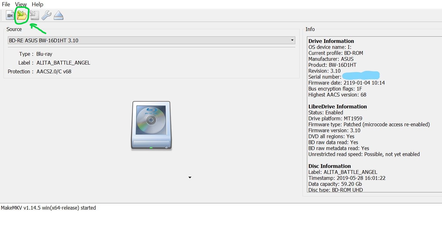

Ok. To decrypt the entire disc to folder, after you insert a disc and MakeMKV gathers the disc information, select the folder option (see green markings on picture). On the popup screen, make sure that decrypt content is checked and select a location to store the decrypted folder.
