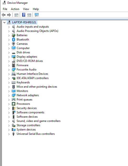

zittrig
Posts: 320
Re: External LG-BU40N has stopped being recognized in Windows.
Post by zittrig »
Is there the "Initio Default Controller" in the device manager? If so uninstall it and check the drive recognition again.
thinredline
Posts: 38
Joined: Sat May 01, 2021 9:57 am
Post by thinredline »
zittrig wrote:
Sat May 31, 2025 3:03 pm
No. I don't see anything like that. Here's what I see:
