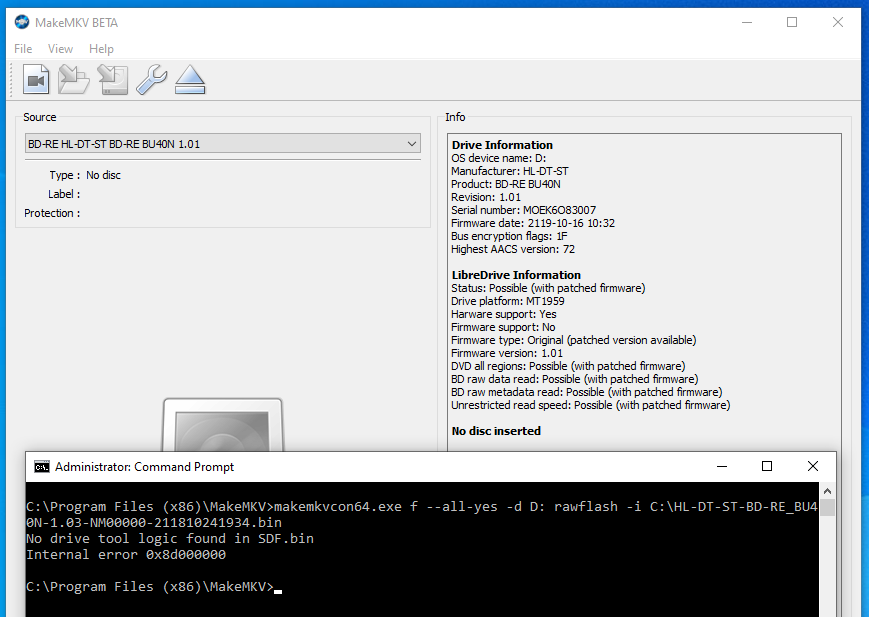

Open a disc in makemkv and try again
Unfortunately that doesn't help
Screenshot 2021-04-19 at 13.49.58.png (92.19 KiB) Viewed 19616 times
i think i know whats wrong what adapter are you using to flash this drive?
What do you mean by "adapter"? It's Archgon external -> https://www.amazon.de/dp/B07B2RMXKW/ref ... 01_TE_item simply connected via USB 3.0 cable.
What's interesting it that it's fixed drive returned to me after servicing. When I bought it new, I had not issues with flashing it, still after some time got broken (started to be very noisy and produced many errors while ripping), I've send it back for guarantee service, and what I received back is a unit, again with a original Firmware, which now I'm not able to flash over.

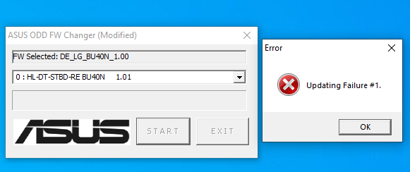

I think it gets same error:
Screenshot 2021-04-19 at 14.12.15.png (35.53 KiB) Viewed 19613 times
I'll see later, maybe I can remove it from case, and check with the other. Still that's weird, as in very same case I was able to flash it previously (when it was new, before servicing)
