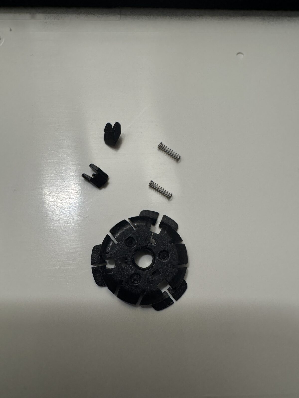

What happened: During normal use a disc ejected with the spindle hub attached. Upon opening the drive I found the 2 of 3 springs + plastic clips loose (Figs 3).

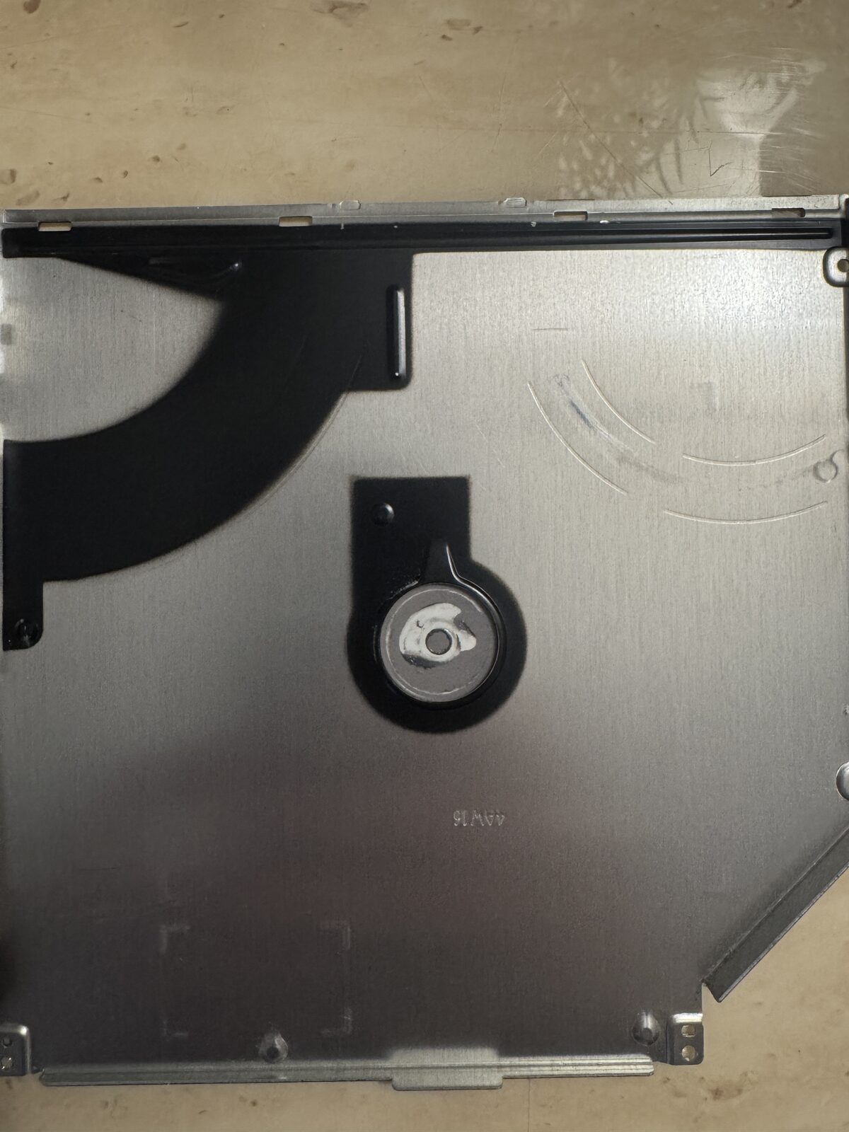

  • 2. Spindle placement Is the sticky substance in the lid cradle (Fig 2) normal, or does it indicate the hub should be bonded in place? i.e. Does the spindle live in the lid and the spindle shaft rises to meet it?

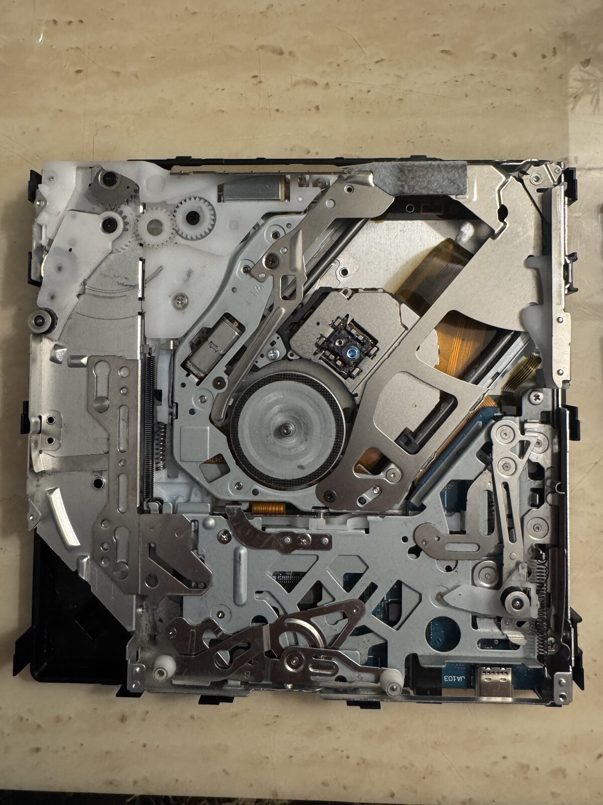

  • 5. Otherwise salvageable? To my untrained eye the unit otherwise looks intact (Figs 1). Is there anything in the photos suggesting the spindle failure is symptomatic of a wider problem?

Fig 1: Mechanism with top cover removed, bare spindle shaft visible, hub absent
Fig 2: Inner face of top cover showing the hub cradle and what appears to be adhesive compound
Fig 3: Spindle / Hub (bottom face), 2 recovered springs and clips.
