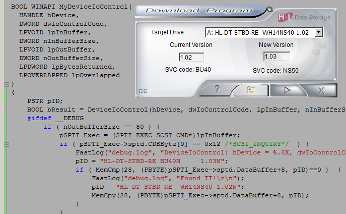

Moving on. Because I write/maintain CD ripping software and know some SCSI, I wondered if I could recover the drive myself with LG's official FlashIt tools. Since SDFtool flashed it to another [wrong] model, it identifies as BU40N in the vendor ID string, so the WH14NS40 FlashIt will exit, tell you it's the wrong drive. So I thought what if I intercept the SCSI command packet, change the string to identify as a WH14NS40 model? Would the flashing proceed with the correct firmware then??
Result:

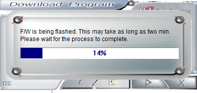

Tricking it with the WH14NS40 FlashIt was possible, but it fails with an Abnormal State error. Not will to give up, I discovered I could continue to activate flashing with LG's final 1.05 BU40N flasher/tool! What I came to understand is it protects itself with a checksum. The firmware is unzipped, decrypted (basic XOR encryption), patched with data in some areas in reaction to drive info, encrypted back before it uses a special SCSI cmd (0xE7) to start flashing, then the standard SCSI write buffer command (writing 16K chunks per iteration for the total 2MB firmware) so it's gonna take someone really talented to possibly figure this out some day!
if ( pSPTI_Exec->sptd.CDBByte[0] == 0x12 /*SCSI_INQUIRY*/  ) {
	pOID = pNID = "HL-DT-STBD-RE BU40N     1.05N";
	if ( MemCmp(28, (PBYTE)pSPTI_Exec->sptd.DataBuffer+8, pOID)==0 )  {
		//pNID = "HL-DT-STBD-RE  WH14NS40 1.00N001600 UNIQUE1711211658MTEKMT1939      \0\0JB8   NS50";
		pNID = "HL-DT-STBD-RE BU40N     1.01N";
		MemCpy(80, (PBYTE)pSPTI_Exec->sptd.DataBuffer+8, pNID);
With this code, now that it identifies as BU40N 1.05N, I trick it into lower version 1.01N, so it passes the version test again, and flashing can continue to be activated - you hear a click, the blue light flashes on/off, result:
But obviously this does me no good, just progress that proves that the LG Flasher is the ONLY tool now that it's bricked that can somehow activate flashing.
