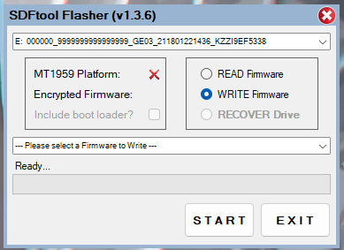

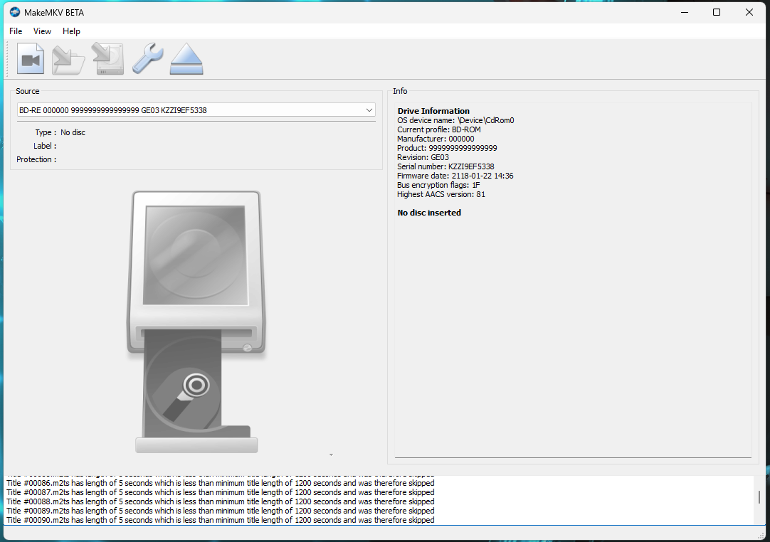

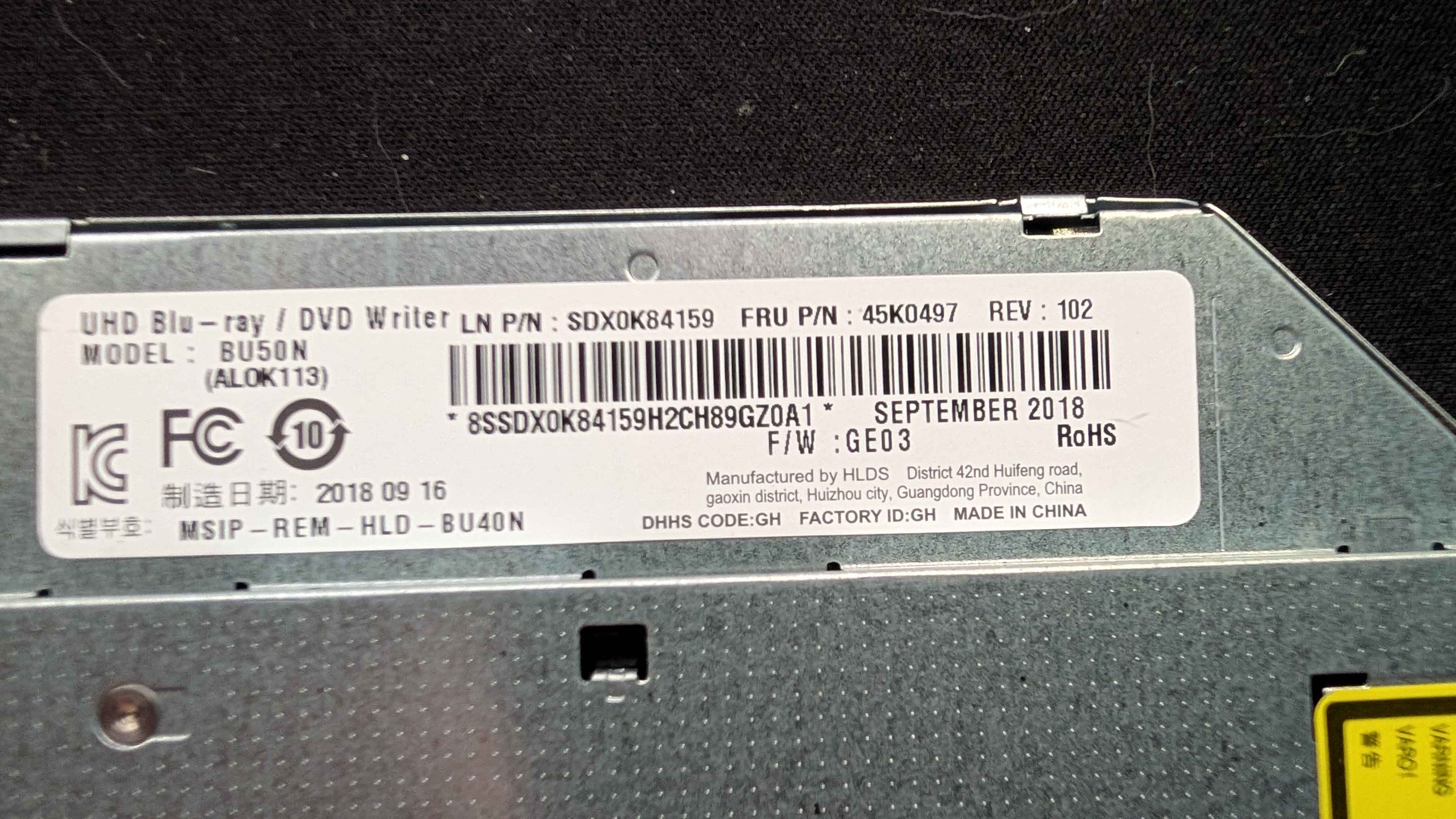

Hi, recently I purchased what I thought was BU50N from amazon with the hope of using sdftool to flash BU40N firmware onto it for 4K ripping but ran into an issue when I opened makemkv and noticed the drive info. Is there any way to make this drive work or should I just return the drive.

How do you have the drive hooked up?
The Info in Makemkv is incomplete.
I would return it.

I am using a Slimline Sata to USB 3.0 adapter
That is what I thought as well so I already started the return.
Thank you for the reply
Posts: 5800
Re: BU50N Firmware Help
Issue is the adapter
Get an approved one from the guide below

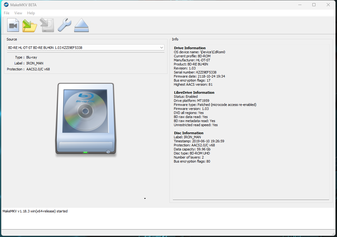

Screenshot 2026-05-21 192841.png (123.01 KiB) Viewed 504 times
