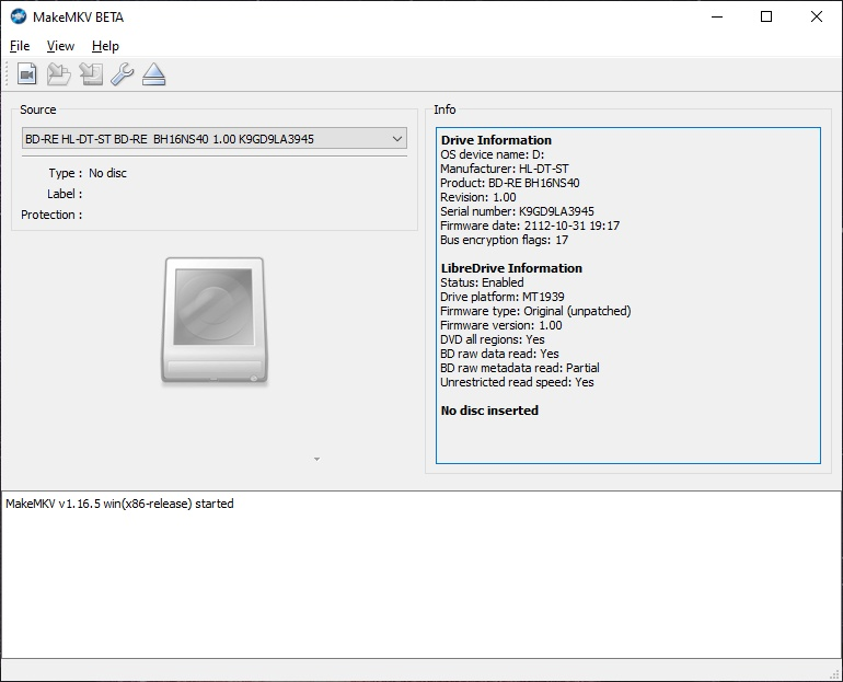

I followed the steps 1 to 6 successfully but am stuck with the final firmware step.
My model is from 2012 and it has no SVC number, only BH16NS40.
Additionally it has marked Rom Version 1.00
I am sure the calibration is ruined.
None of the bin files work.
Does someone have the right firmware for this model?

Hello everyone.
I have the same problem as @virtualrom - model from 2012 BH16NS40, firmware version 1.00 and none of the above manuals work for me. I also tried to move the calibration data from BH16NS40_v1_03A_with_BH16NS40_v1_01_calibration.bin to the original firmware HLDS_JB7_BRAND_1.00_NOBJ_DE.bin but it still does not read any disk after writing with DosFlash.
Some ideas? Thanks
Some ideas? Thanks

Post your drive info section from makemkvPauloCZ wrote: ↑Tue Jan 25, 2022 8:07 pmHello everyone.
Some ideas? Thanks

Here is my info MakeMKV:
- MakeMKV1.png (166.2 KiB) Viewed 18245 times
- Posts: 5690
Re: LG BH16NS40 bricked?
Well it's dead then you have it back on the right firmware and the serial number is there that's included with cal data
