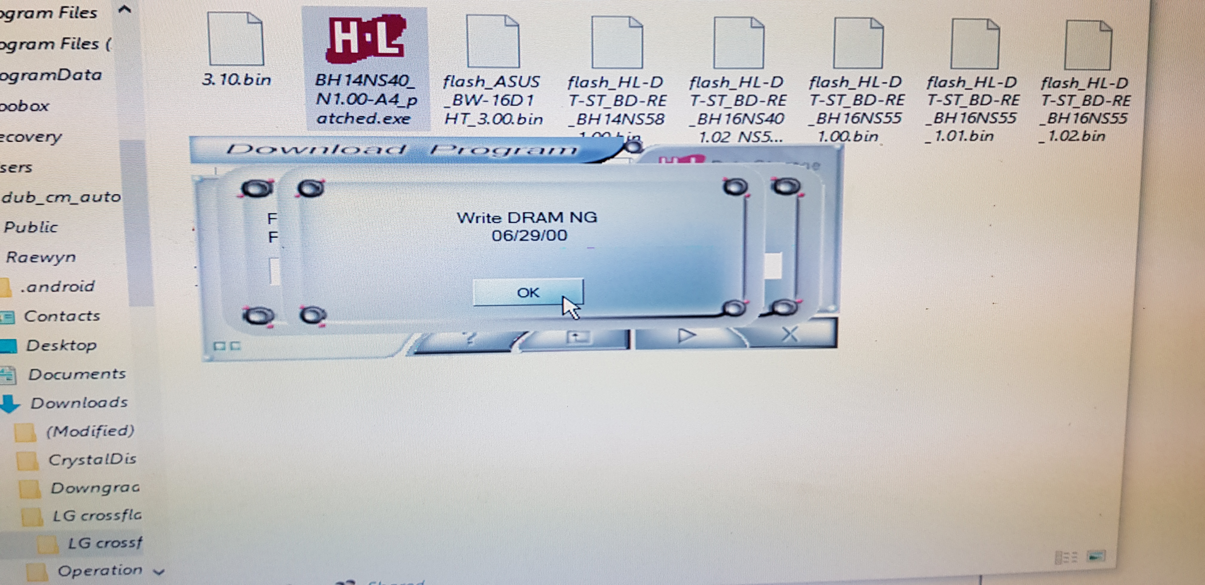

Getting Write DRAM NG
Is that progress or problems? Haha
- 20190717_184215.jpg (3.38 MiB) Viewed 31205 times

Re: LG BH16NS55 Firmware 1.04 (and possibly other new drives)
this is a weird one the only other thing i would think it is beside the flashers not liking your sata controller is if lg has another version of 1.04 that is different from the other and it blocks it again.killkong1211 wrote: Wed Jul 17, 2019 8:39 am32bit allowed me to launch the app but same issue, gunna try on the win 7 nowBillycar11 wrote: Wed Jul 17, 2019 8:31 am i did use 32 because old dos flash needed it but i wouldn't think that would matter but i guess try 32 bit
you are sure you are selecting asus 3.10mk?

where did you get that asus 3.10 it is not labeled like that from mike mk firmware packkillkong1211 wrote: Wed Jul 17, 2019 8:43 am Getting Write DRAM NG
get the asus 3.10 mk from here: https://www.makemkv.com/forum/viewtopic ... 19&t=19113

Definitely selecting the 3.10mkBillycar11 wrote: Wed Jul 17, 2019 8:45 am this is a weird one the only other thing i would think it is beside the flashers not liking your sata controller is if lg has another version of 1.04 that is different from the other and it blocks it again.
Manufacture date is April, so I guess it's possible since I've seen a lot of the posts referencing the NS55 1.04 mention a feb date.
But you'd know better than me on that
I grabbed it from there and relabled it cause I saw another post mentioning issues with a long file name
Edit: downloaded again just in case I got a bad copy, no change

i have still to get a 1.04 lg and i have gotten some from after feb 2019 lg seems to not have done it for the wh drives in the usa yet i get 1.03 BU40Ns all the time though. im kinda out of ideas then sorry.killkong1211 wrote: Wed Jul 17, 2019 8:50 amDefinitely selecting the 3.10mkBillycar11 wrote: Wed Jul 17, 2019 8:45 am this is a weird one the only other thing i would think it is beside the flashers not liking your sata controller is if lg has another version of 1.04 that is different from the other and it blocks it again.

All good, the help is much appreciated even if we didn't crack the case tonight.Billycar11 wrote: Wed Jul 17, 2019 8:57 am i have still to get a 1.04 lg and i have gotten some from after feb 2019 lg seems to not have done it for the wh drives in the usa yet i get 1.03 BU40Ns all the time though. im kinda out of ideas then sorry.
If you wanna get hands on with a 1.04 I got mine from PCCasegear
And hey at least now we know 32bit is the only thing to run the flasher haha
Edit: Further bad news, tried using my NAS booted off the PE which is the middle set of hardware between my win 7 and win 10 and I got the same error as on the win7, that doesn't seem ideal
