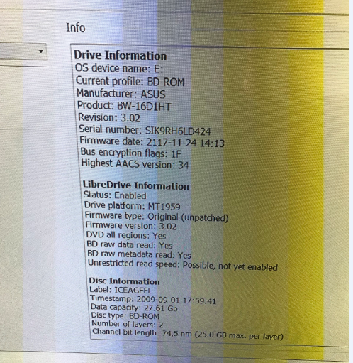

Crossflash to bw-16d1ht 3.02

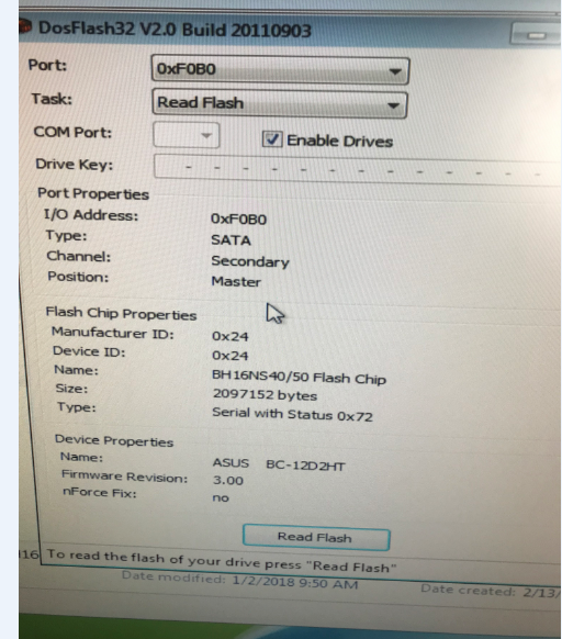

Mine was already on 3.00 i have de dump i’ll post it later picture file Is to big to post
Used to dump hirensbootcd 15.2 with DosFlash32_BH16NS40 on another computer then used in windows 10 the BH16NS40_EEPROM_Data_Mover and then the asus odd fw 3.02 updater for bw-16d1ht (patched)
Tested to write bd-r mediarange and no sucess on imgburn
Dvddl verbatin fine
I have to make another testing then i’ll post
havent tested uhd medias
Thanks to all who helped with info pics and usefull information
