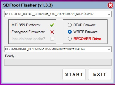

Hello everyone,
I got an LG Hitachi - BH16NS55 and wanted to use the SDFtool Flasher (1st post) and the recommended firmware (HL-DT-ST-BD-RE_WH16NS60-1.02-NM00100-211810291936)
When selecting the device I will get an error window (https://prnt.sc/-ybXYwerJP6b) and an error message:
Running on W10 x64 and started it with empty/closed tray and admin rights:
https://prnt.sc/jjgaF2cw32Cs

Any idea on that? Can I just continue flashing or what did I do wrong?
TomKay
Joined: Wed Jun 01, 2022 2:23 pm
Re: SDFtool Flasher
Post by TomKay »
Nevermind - I used dvdfab's feature to downgrade my drive. it worked :)

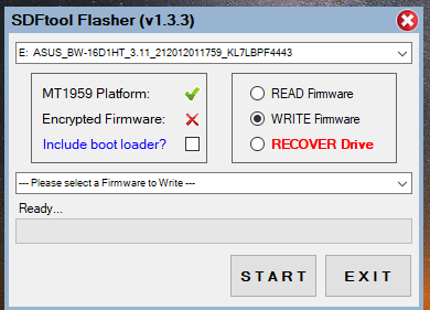

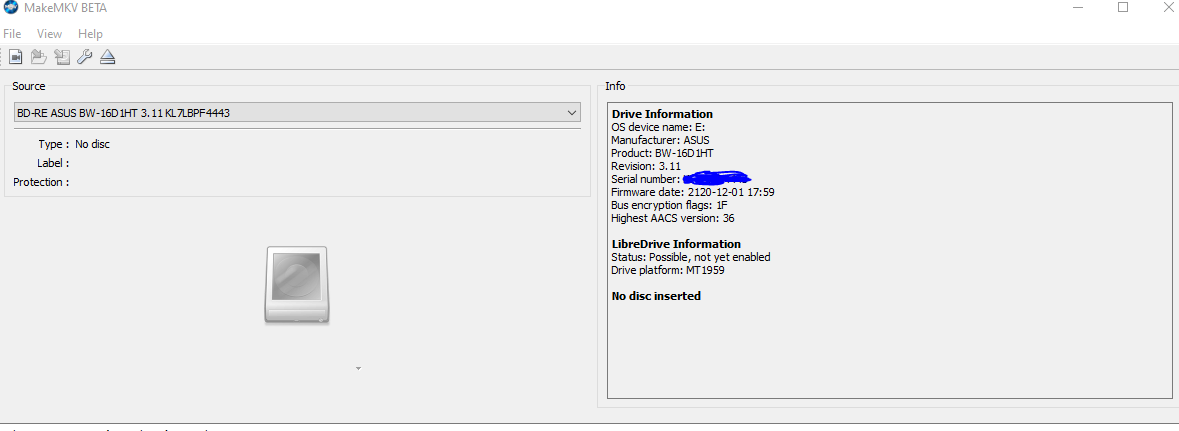

I have a ASUS BW-16D1HT connected to my laptop via usb / Sata, please see information about the drive here: (Screenshot 1)
Screenshot 1
Screenshot 1
screenshot 1 _ makemkv drive info.PNG (24.21 KiB) Viewed 19772 times
I see that the firmware isn't encrypted as per this screenshot obtained via the SDFtool (Screenshot 2)
Screenshot 2
Screenshot 2
screenshot 2 _ sdftool drive info.PNG (25.78 KiB) Viewed 19772 times
Although I tried flashing the drive using the ASUS flash tool, it was throwing "Updating Failure #5". Will the SDFTool be able to help?
I am keen to knwo how do I proceed?
Thanks in advance.

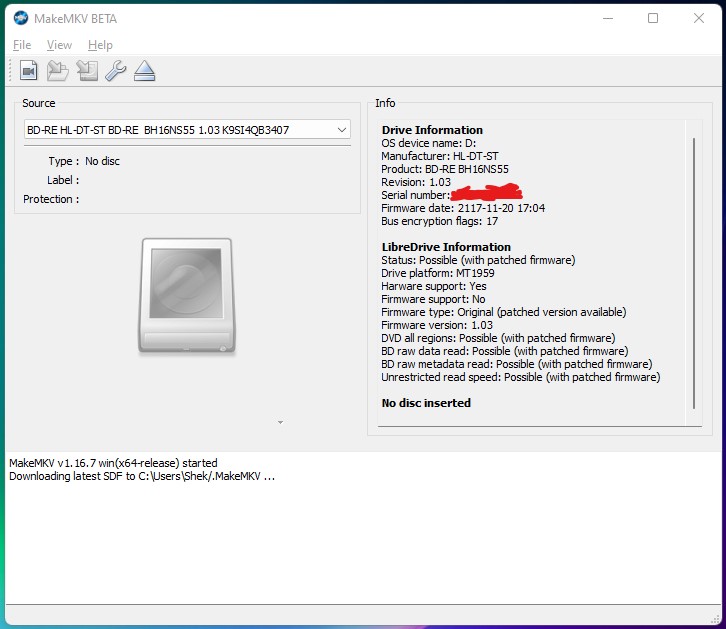

hallo
i am trying to flash my BR Drive, Model BH16NS55 with friendly Firmware,
which firmware for this drive
see the Pic that i have added
for Example i have selected MK version(see Pic)
is this correct, pls help meeee
edit:
as i understood i should do the following:
1- BH16NS55 on any Firmware directly to > WH16NS60 1.02MK
2- WH16NS60 1.02MK > DE_LG_WH16NS60_1.00.bin
is that ok

It is encrypted use the command line flasher and use enc or download an old version of sdf GUI
It would also be helpful if you read the firmware and send it to Marty he could then add it to the list

I'm not aware of any ASUS drives having encrypted firmware. Try flashing it to ASUS BW-16D1HT 3.10-MK using SDFTool flasher. It willl either flash successfully or it will not flash at all.
If the firmware is infact encrypted (I still doubt it) you can easily toggle the encrypted flag in SDFtool flasher by clicking on the red X.
papacarter
Joined: Thu Apr 23, 2020 3:16 am
Re: SDFtool Flasher
Post by papacarter »
Hi Marty,
Legend ! Thanks for the suggestion and it worked like a charm :D
Truly appreciated!!
Thank You again 🙏
Posts: 5826
Re: SDFtool Flasher
papacarter wrote: Wed Jun 22, 2022 6:11 am Hi Marty,
Truly appreciated!!
Thank You again
so was it encrypted did you click the x?
