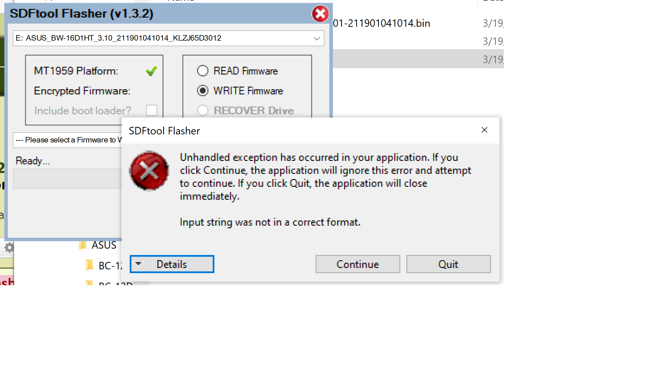

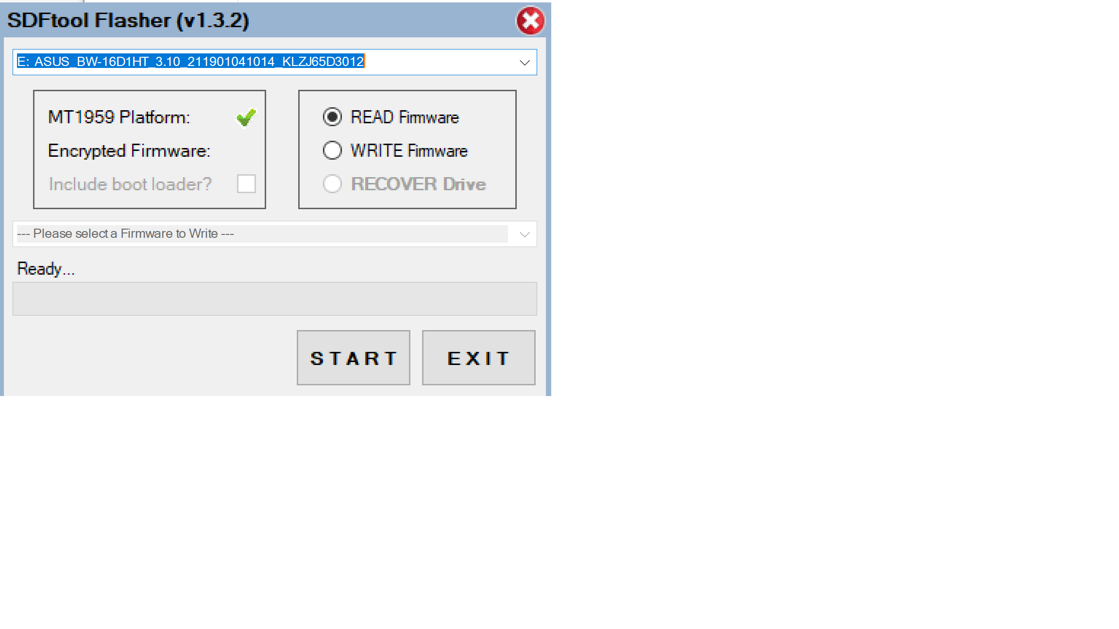

Getting an input string format error when I select my ASUS drive (see attachment).
The popup lets me continue on, but I'm leary of pulling the trigger on drive flashing after the error.
Note: there is no status on the 'Encrypted Firmware' field (after selecting the ASUS drive).

- After Continue - No Encrypted Firmware status..png (43.09 KiB) Viewed 19073 times
- SDFtool Flasher Error.png (90.75 KiB) Viewed 19073 times
- Posts: 4900
Re: SDFtool Flasher
Ok, it looks like SDFtool Flasher is having trouble with the encrypted firmware check for the ASUS drive. I'll look into that. Please use the old version in the meantime.mwtimken wrote: ↑Sat Mar 19, 2022 8:54 pmGetting an input string format error when I select my ASUS drive (see attachment).

Re: SDFtool Flasher
Okay, used the older version and I'm off and running. Flash was okay, doing some 4k ripping now
Thanks for getting me going!
