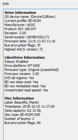

mhaider
Joined: Thu Dec 10, 2020 2:08 am
Re: Ultimate UHD Drives Guide Updated 2020
Post by mhaider »
I have a Asus BW-16D1HT that has 3.00 FW, what's the advantage to updating the FW to Asus BW-16D1HT 3.10MK?
Here's what MakeMKV reports about my drive.

mhaider wrote:
Thu Dec 10, 2020 2:25 am
Very little... 3.10-MK is a little faster. That's about it.
