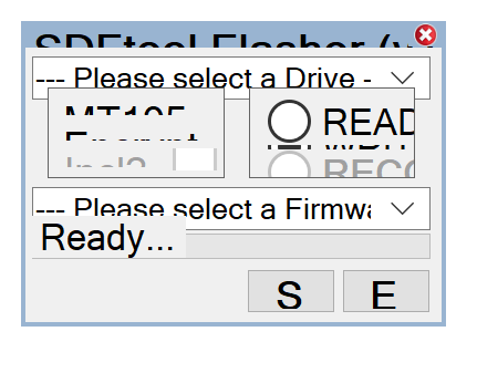

Hey, sorry new member here and don't know if it's been covered.
Downloaded and tried v1.31, but the window is coming up compressed -
Using a fairly fresh W10 install, anything I need to add?

freakdiablo wrote:
Sun Feb 06, 2022 8:16 pm
Had you read through this very thread... viewtopic.php?f=16&t=22896&start=330#p114370

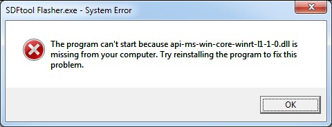

Hi, I did a search but couldn't find any similar errors.
I can't run the latest v1.3.1 sdftool flasher on my Win7 x64 Pro install. It comes up with the error here:
Am I missing some dependency?

bd-one wrote:
Wed Feb 09, 2022 6:29 am
I had the same issue w/ Win 7 X64 & guessed it was a component of some Win dev stuff I otherwise didn't need? Downloaded the .dll from a trusted source, dropped it in the dir w/ SDFTool. No more error. It was more direct than doing research to determine what was missing. YMMV
That is because Win 10 x64 is a requirement.
bd-one
Joined: Wed Feb 09, 2022 6:08 am
Re: SDFtool Flasher
Post by bd-one »
MartyMcNuts wrote:
Wed Feb 09, 2022 10:04 pm
DERP. I see it now, right in the OP, under requirements. Thanks.
