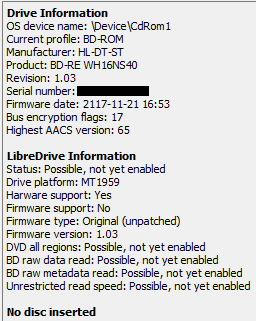

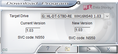

So I bought my WH16NS40 on a whim after reading that it would do UHD disc and was disapponted to find that it came with the 1.03 from the factory
According to the LG flasher I have SVC code NS50
Which I understand to mean that I'm good to go.

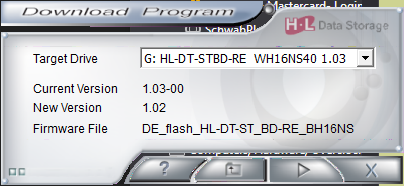

I snagged the .zip and after a but of duh-huh I noticed the folder icon and got it to pick the correct firmware. Before I pull the trigger, am I right in thinking I'm not going to make a $60 brick?

@KiltedShane,
Go for it. I see you've chosen a DE (downgrade enabled) firmware from Billy. That's all you need to do. The flashing will take a minute and then tell you to reboot. (I didn't reboot when I flashed one of my drives and it downgraded fine. I'm using it right now.)
- Posts: 5831
Re: Firmware downgrade using official (patched) flasher, the "Ultra hax0r guide"
yeah all you do is click the folder and choose the fw for your drive, what you have now will work but why not chose the wh16ns40 ns50 1.02 your exact drive model you have bh16ns40/50 selected cant see last number.KiltedShane wrote: Fri Feb 08, 2019 2:35 am
and as mike said it is very hard to brick a drive this way it will leave the drive in a recovery state that you can reflash it

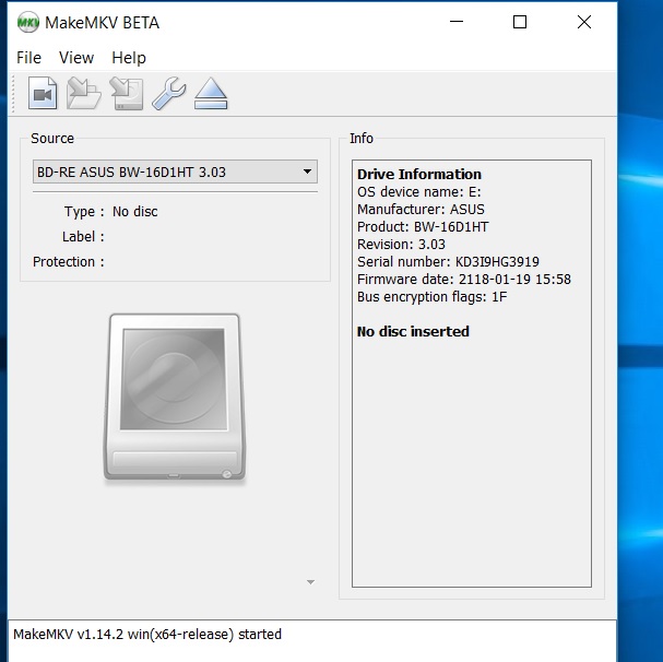

hey peeps
right my asus BW 16D1HT drive and icybox arrived this morning
im a little confused but hopefully all went well, i had downloaded the patched updater and all the bins! from this thread
so i loaded the updater, it stated the drive was on f/w 3.03, so i thought from here when i clicked start it would ask for the location of the bin file for 3.02 but instead it just updated!

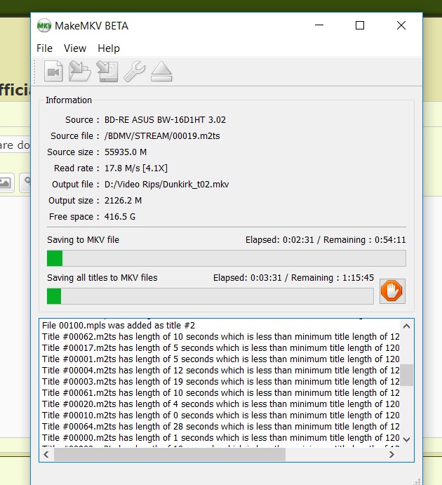

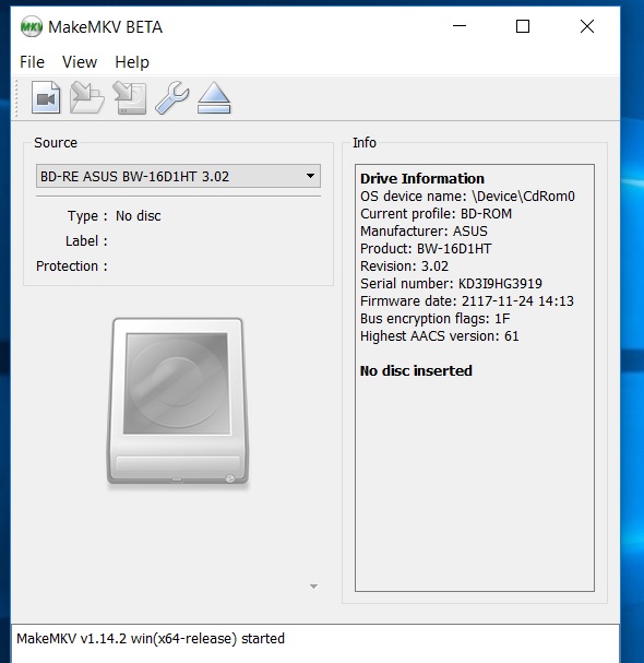

anyway far enough, so I restarted makemkv and sure enough it reported the drive is now 3.02 YAY ( i think)
so thought i would just go with the flow, as have used makemkv for many years ripping my 3D films, and loaded Dunkirk 4K disc and went thru what i normally do with the mkv's! so currently its ripping 50GB approx to my hard drive
is this right, was i supposed to do anything before hand, seemed to remember reading something about hash keys!!
- ASUS_BW-16D1HT_3.03.jpg (70.5 KiB) Viewed 40625 times
- ASUS_BW-16D1HT_3.02.jpg (69.49 KiB) Viewed 40625 times
