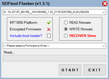

you didnt flash your drive
check the enc box if its not already
and choose WH16NS60 1.02MK from the all you need pack linked in the guide below

If by enc you mean the encryption firmware check i clicked it to an x.
If there is anything else i dint see it.
I ran the process not sure why its not taking….does the the mt1959 uncheck or have the ability to b clicked. If i click it nothing happens
Not sure what else to do...

No, your drive has encrypted firmware so the encrypted firmware check needs to be a tick. If you are having trouble flashing, tell us how the drive is connected to your PC?

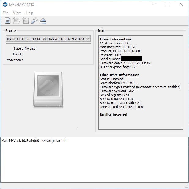

Finally success! Or appears so…on the first disk 4k rip. Initially when i had the tick something was off so when i went back i got confused…either way it works. Thank u so much for your patience,
Now i did the “read” option to copy the original firmware (i think thats how it works at least) before i changed anything .
