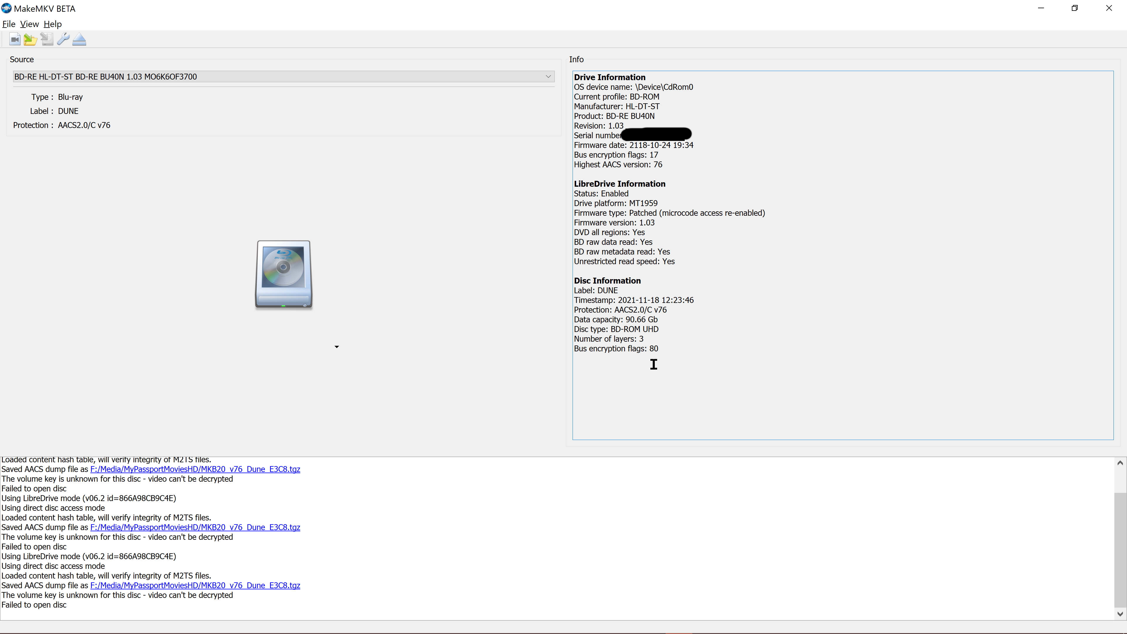

So I'm having this error. I thought I did the firmware upgrade correctly, but get this...
Ideas or known facts are appreciated.
MKB20_v76_Dune_E3C8.tgz
(3.34 MiB) Downloaded 415 times
Posts: 5676
Re: SDFtool Flasher
therapy80301 wrote:
Thu Jan 13, 2022 3:05 am
your firewall is likely blocking hk downloads or you disabled contacting webserver for updates
Posts: 4861
Re: SDFtool Flasher
Yes, you flashed the drive successfuly.
Also, to add to what Billy said, the disc you are trying to rip is Dune, which a lot of people are still waiting for decryption keys to be added. You might be in the same boat. If you haven't already, send in the Dune dump file to svq@makemkv.com and exert some patience.
