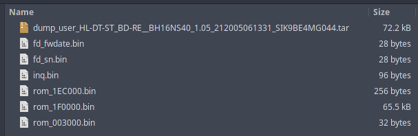

Here's a screenshot of what's in the .tar archive if it helps (this dump was taken from the bad (NS50) firmware that still should've had my calibration data, as I had just flashed it over the stock and working 1.03)Billycar11 wrote: ↑Fri Mar 26, 2021 11:48 pmi dont know how the cal data is stored in the tar file or if it is but i think it is. maybe mike could offer advice on how to move move it out to a firmware to flash.
mike admin wrote:

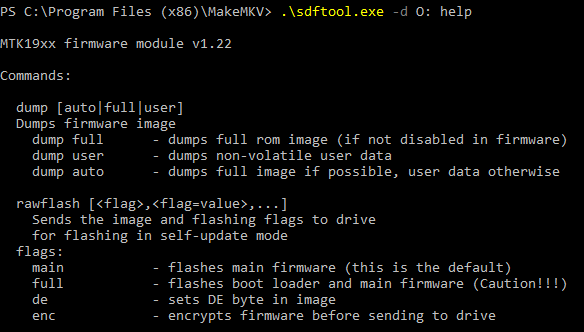

I have no clue (Billy indicated he didn't either, perhaps you do?) if it's possible to recover my calibration data from the dump I made of my old firmware using sdftool, but that's my only chance at this point. It seems Mike might be the only one with those answers so I'm probably just hoping he responds at some point. The sdftool read firmware function makes a .tar archive with six different .bin files, and I'm definitely not confident enough to guess which one is which or how to properly flash them back to my drive.
Based on the man page for sdftool and the filename of the .tar archive, I probably did a non-volatile user data dump: ...but the filenames it creates are a bit too cryptic for me to confidently start flashing them to my drive (see the pic in my previous post), and I can't find any further info on what each of the .bin files might be.
