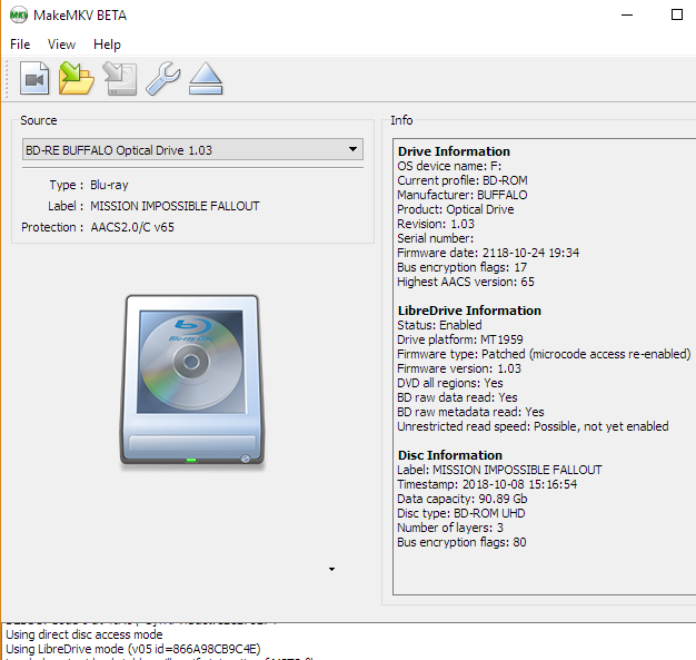

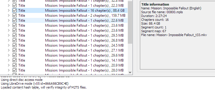

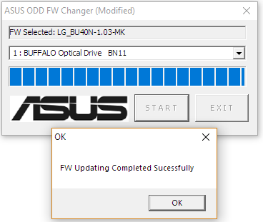

just wanted to report back that my Buffalo BRXL-PT6U2VB is a UHD-friendly device now:
1. Crossflashing worked like a charm with this MK firmware
2. Device shows up as LibreDrive compatible:
3. and CAN FINALLY READ UHD-blurays:

Can anyone confirm if this works on a device that shows up as a BU11 rather than a BN11 in the modified ASUS flasher?
Posts: 5796
Re: Is there a way to downgrade the firmware on a Buffalo BRUHD-PU3 from BU11 to BU10?
babypuncher wrote:
Sat Jun 22, 2019 4:07 am
no idea just use my de bu10 i tested it on a buffalo drive that said bu11
my de: https://www.makemkv.com/forum/viewtopic ... 873#p70284
martys asus flasher: https://www.makemkv.com/forum/viewtopic ... 16&t=18933
the drive can not be downgraded by the lg flasher in the case only the asus one works for that
