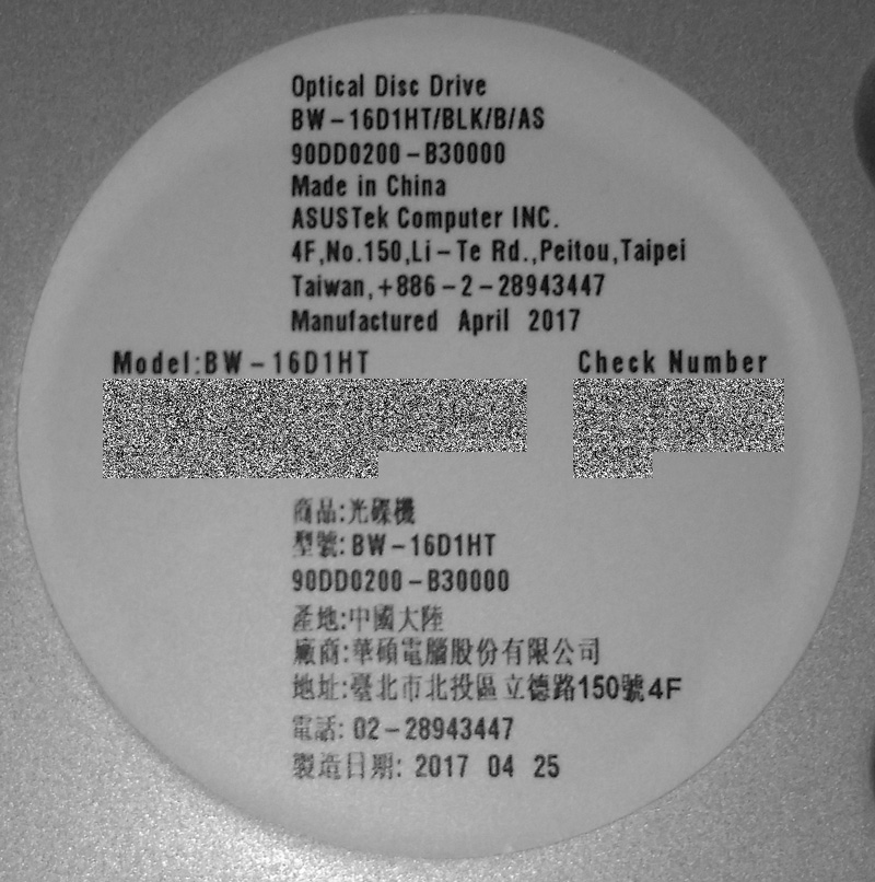

"Good" firmware are still in stock, just bought mine as bulk from amazon prime eu
Got firmware 3.01
Got firmware 3.01
- IMG_2018-02-19_18-40-14-bw.jpg (188.07 KiB) Viewed 53092 times
