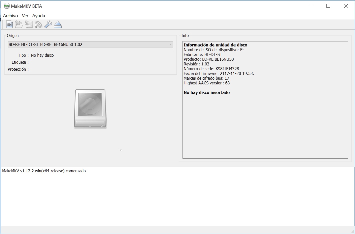

Post by paniyo »
I got LG BE16NU50.Version 1.02
makemkv tells me there is no disc
what am I missing
what am I doing wrong
Thank you
Posts: 10926
Re: UHD drives
If it shows the Service Code of NS50 or higher, it should read UHD disks, at least to the point of being able to show the disk being loaded.
paniyo
Posts: 10
Joined: Thu May 03, 2018 11:02 am
Re: UHD drives
Post by paniyo »
this is what appears to me
open and close and nothing
begins to start and leaves the image
Woodstock wrote:If it shows the Service Code of NS50 or higher, it should read UHD disks, at least to the point of being able to show the disk being loaded.
jonghotti
Posts: 997
Re: UHD drives
Post by jonghotti »
paniyo wrote:I got LG BE16NU50.Version 1.02
what am I missing
Thank you
Sorry about that, a picture of the sticker on the back if you would please.
