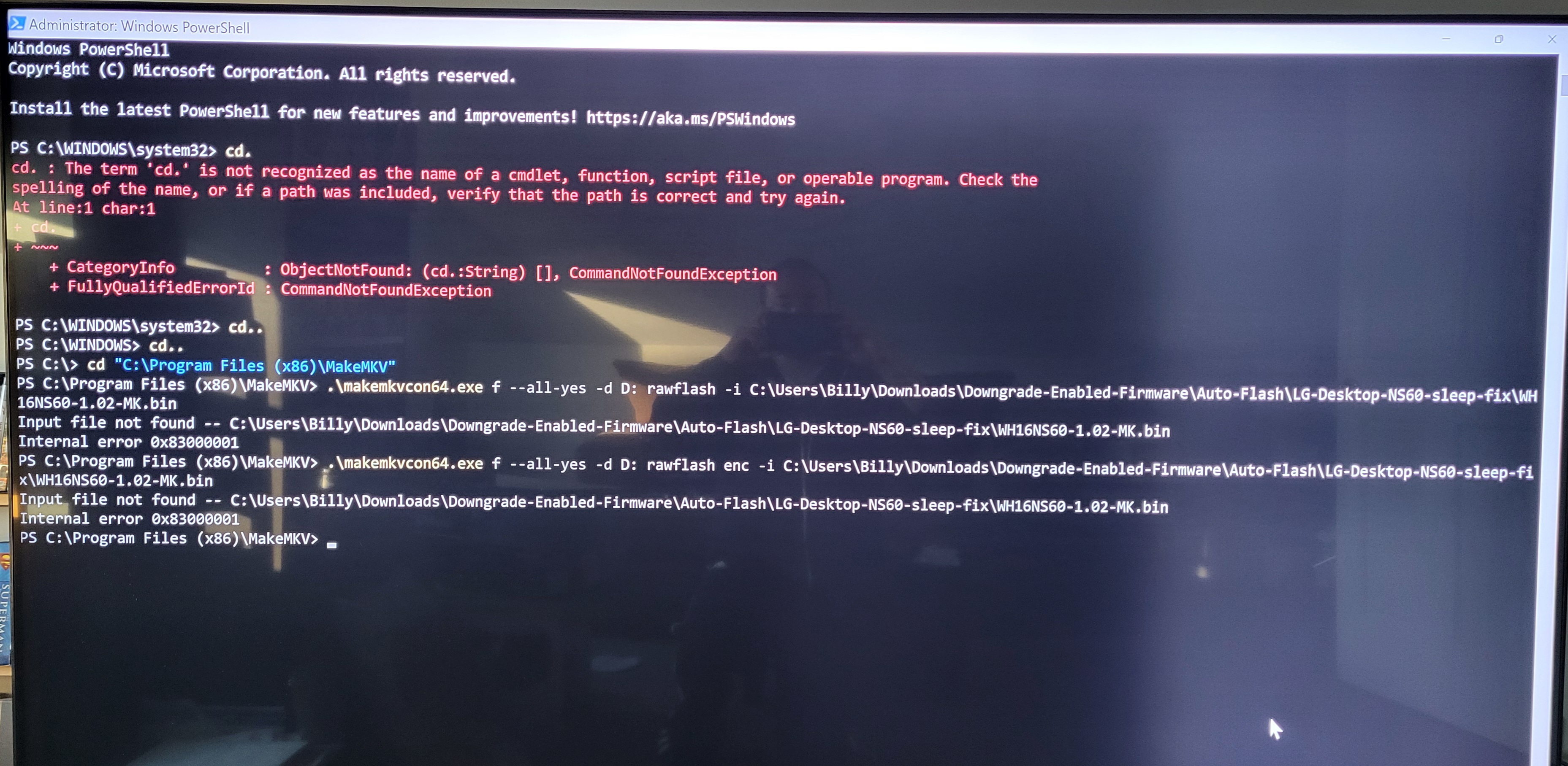

Sorry I expended the screen to see the full file name
Posts: 4485
Re: Ultimate UHD Drives Flashing Guide Updated 2024
MrMegadeth99 wrote:
Thu Dec 12, 2024 1:28 pm
In my downloaded firmware pack the file name is HL-DT-ST-BD-RE_WH16NS60-1.02-NM00100-211810291936.bin. Not that short as yours. Switch to that directory and do a DIR to see the file name.
SDFToolFlasher. Just start the program and pick the .bin file from that directory that you use in your command line where the .bin is located.

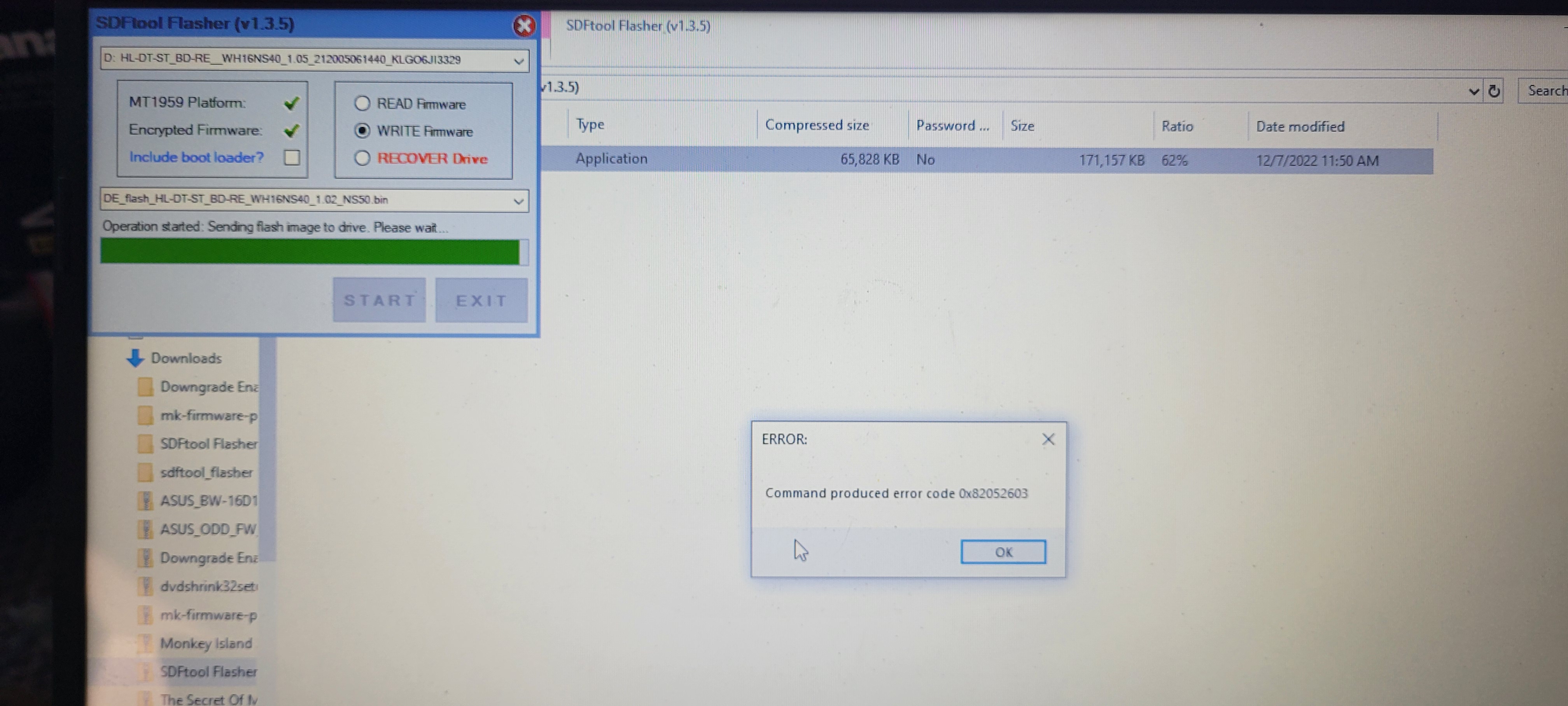

I used the SDFToolflasher and got this error code. Do you know what this means?
Posts: 4485
MrMegadeth99 wrote:
Thu Dec 12, 2024 1:49 pm
Are you in panic mode???
Now you are trying to flash DE_WH16NS40 1.02. You are supposed to flash WH16NS60 1.02. Only after a succesful flash you can also flash other firmware. You understand xxx60 instead of xxx40.
Thee guide recommends...
WH16NS40 on any Firmware directly to > WH16NS60 1.02MK
Download the 'all you need firmware pack' & extract 'HL-DT-ST-BD-RE_WH16NS60-1.02-NM00100-211810291936.bin'. Flash that.

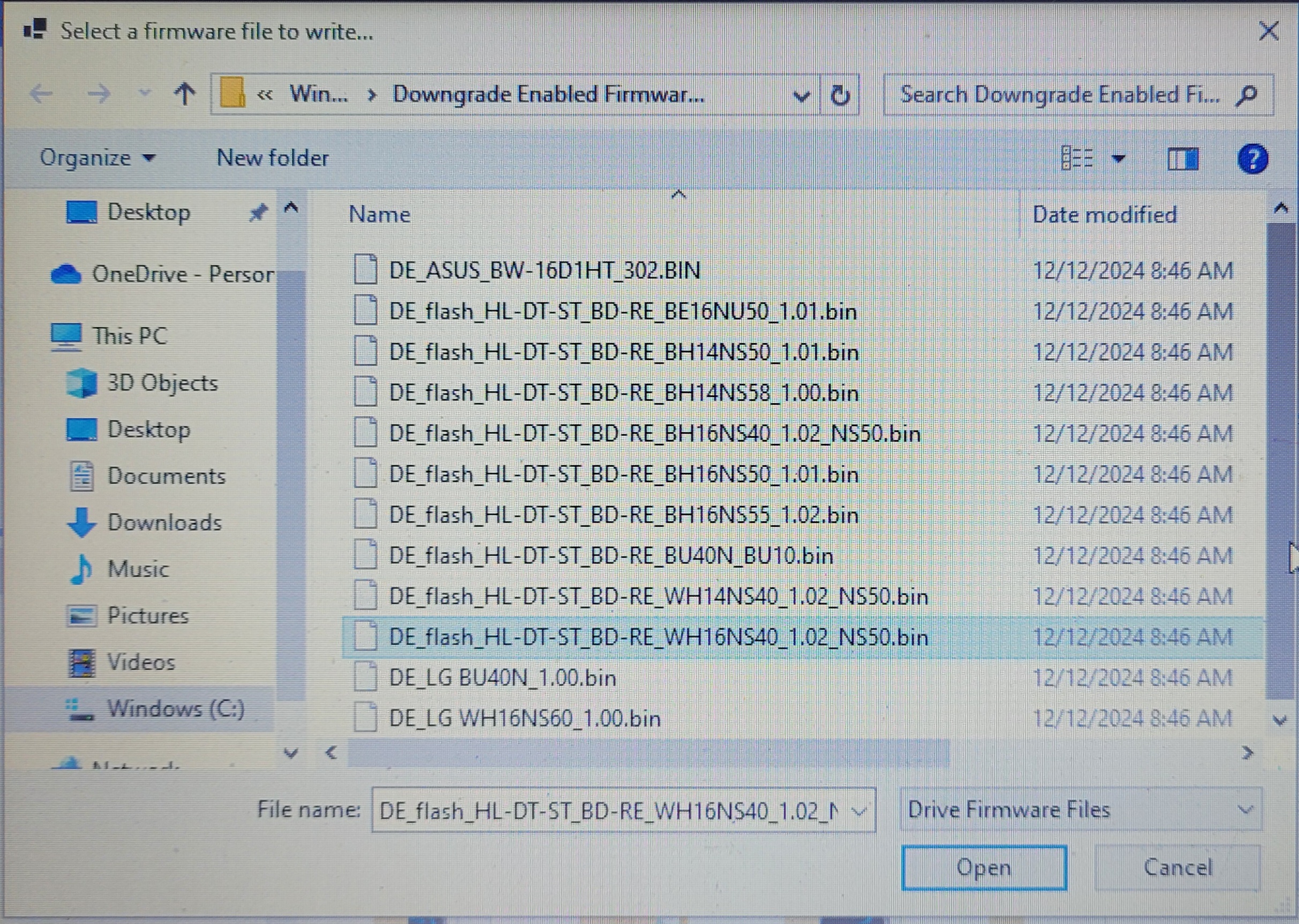

How do I do that? I only have the options below. I tried the LG WH16NS60 but got the same error code.
Posts: 4485
MrMegadeth99 wrote:
Thu Dec 12, 2024 2:03 pm
You need the MK firmware pack, not the downgrade enabled firmware pack. In the MK firmware pack look under the folder OLD.
Or also the all you need firmware pack from Marty listed where SDFToolFlasher is available.

MrMegadeth99 wrote:
Thu Dec 12, 2024 4:21 pm
Yes it worked not thanks.
What commands?
The directory path you used in your power shell script: Billy blahblah. We are sure that directory doesn't exist on your computer.
MrMegadeth99
Posts: 24
Joined: Sat Jun 08, 2024 3:01 am
Post by MrMegadeth99 »
No clue I just followed the YouTube video
