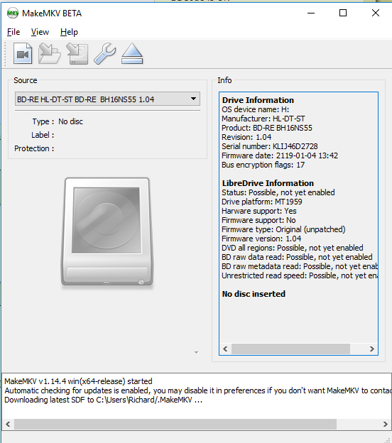

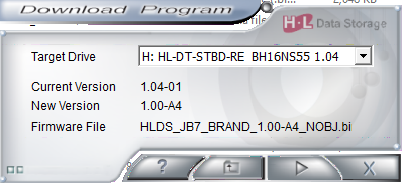

Hi All,
I just purchased an LG BH-16NS55 with firmware version 1.04. I was wondering if;
A) I have not seen any reference to this firmware version, should I make a backup before I flash to 1.02? Do I need to do this anyway?
B) Has anyone with version 1.04 flashed their drive successfully?
C) Will the LG flasher (N1.00-A4) tool work with this firmware version (attached screenshot) or is there a better tool?
Any advice will be appreciated.
Thank you all.
Posts: 5796
Re: Firmware downgrade using official (patched) flasher, the "Ultra hax0r guide"
JensenJ wrote:
Wed Jul 03, 2019 11:09 am
Hi All,
Read the Newer OEM Firmwares section on the second post d00zah linked

I'm having trouble with the LG BH16NS55. I start the application and choose my bin file, but after clicking start, it gives me and error. The drive is still in working order after. Any help is appreciated.
st4evr
Posts: 705
Post by st4evr »
bear2019 wrote:
Wed Jul 10, 2019 7:18 am
You need to provide additional information.
What is the exact error being presented?
What is happening exactly?
This is an online forum. Simply saying “it does not work” does not help. We are not sitting next to you nor are we mind readers. Help us help you.
bear2019
Joined: Wed Jul 10, 2019 7:14 am
Post by bear2019 »
hello thank you for replying- i think the error is Write DRAM NG i watched the youtube video (latest) downloaded the installer I chose my bin. It does not go to percentage complete- as soon as I press play it comes up with this error. The drive is installed in the computer, i even tried the Asus firmware installer with the correct bin, still no luck. Like i said the drive is still in working order. Thank you
Posts: 4900
Please provide some details. Simply saying that is of no help at all. Let's start with...
1. What OS are you using?
2. What firmare does your drive have? If it is 1.04, you must flash ASUS BW-16D1HT 3.10-MK first, then you can flash whatever firmware you like.
3. What flashing tool are you using?
4. What error are you getting?
5. How is your drive connected to your PC?
6. Do you have any other software running that uses the drive (MakeMKV, AnyDVD or any other disc accessing software)?
Cheers.
