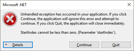

Hi, getting this error window from SDFtool Flasher under Win10 64
Afterwards the tool starts but doesn't list the drives. Any idea how to fix that error?
I have 3 drives in total on SATA. I have flashed 2 before some years ago. Now I am trying to flash the latest one

gabbett1 wrote:
Wed Jan 14, 2026 3:13 pm
Hello, and thank you for the work that you've done. I downloaded the SDFtool Flasher v1.3.6 and tried to flash my drive (LG BP60NB10 (2025 version)). When I tried to do the flash I was given an error from SDFtool.
error:
Command produced error code 0x82052400
Then another window from SDFtool Flasher that states:
Unhandled exception has occurred in your application.  If you click continue, the application will ignore this error and attempt to continue.  If you click quit, the application will close immediately.
Input string was not in a correct format
When I click on details, this is what it says:
See the end of this message for details on invoking

Post the MakeMKV drive info and libredrive info sections for the drive.

When I open the SDFtool Flasher for this drive I get the same error previously noted: StartIndex cannot be less than zero (which I believe is not a "show stopper". Once I advance to the software window, I don't see a drive available for flashing (i.e. there's no option available in the pulldown menu for the drive. I don't know if it matters, but I've removed my previous Asus drive as an option and have assigned the new drive the "D" drive letter. (I believe I'm OK with the flash version needed and it's available to me from the "all you need firmware pack" (LG Slim BU40N) - but I can't get there without being able to select a drive.) Please let me know what I'm missing here.
