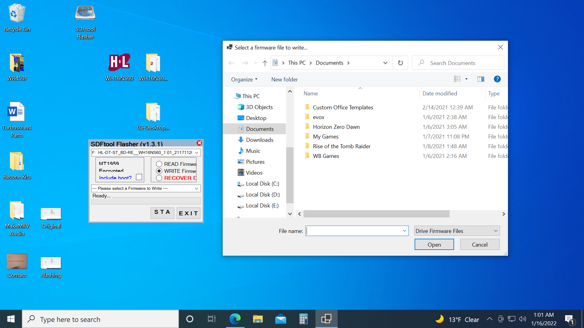

Yes, I read the entire post about 3 times, and I don't see any instructions. I have the option to READ, WRITE and RECOVER but I don't know which I am supposed to do. I assume that I need to select write and choose a firmware to write. Although, I don't have a firmware to choose from. Am I supposed to download a specific firmware and if so, where do I download it from?
Thank you,
Thank you,

- Posts: 4784
Re: Full Size Desktop 4K UHD Drive
You should also download the firmware pack. Links are in the same place. There will be a WH16NS60_1.02 firmware in there.leosantare wrote: ↑Sun Jan 16, 2022 6:02 amYes, I read the entire post about 3 times, and I don't see any instructions. I have the option to READ, WRITE and RECOVER but I don't know which I am supposed to do. I assume that I need to select write and choose a firmware to write. Although, I don't have a firmware to choose from. Am I supposed to download a specific firmware and if so, where do I download it from?
Thank you,
Also, in your pic, the flasher font is too large. This usually happens on a 4K monitor. Right click the exe and select properties. In the compatibility tab, click "Change high DPI settings" then under "High DPI scaling override" tick the box and select "System (Enhanced)" in the dropbox.
