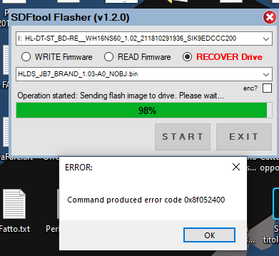

Re: LG BH16NS40 bricked?
An error returns:
Command produced error code 0x8f052400
- error.PNG (25.79 KiB) Viewed 28612 times
- Posts: 5676
Flash WH16NS60 1.00 with the lg or Asus tool and try the recovery option one more thing after that you will have to do it the dos flash way
