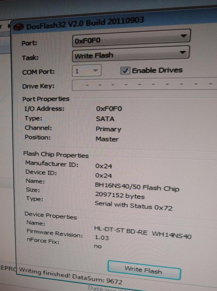

I've tried following these steps as best as I can understand them, but I'm getting stuck...
As with the OP, I flashed NS50 to my NS40 drive and now it can't read discs. I was able to boot into a 32bit Windows and get DOSFlash to see the drive, but I have no binary to flash to it. I downloaded what was supposed to be the stock firmware, but it's an EXE, not a BIN. No one seems to have the actual firmware file that I can just flash to the drive. Is there some way to get the BIN file out of that EXE, or some site that I can download it from?
The drive is WH14NS40 on 1.03.

Re: Help an idiot with a 1st gen WH14NS40
You have to extract your firmware with dosflash first.Ceetch wrote: ↑Sun Jul 21, 2019 11:54 pmI've tried following these steps as best as I can understand them, but I'm getting stuck...

And apply calibration data (DataMover) to this:
I finally managed to get DOSFlash to work and get my old firmware out. I also got the firmware extractor tool that got the BIN out of the EXE and copied the calibrations to it and I was able to flash it back to my drive and resurrect it. Unfortunately, I had to do this using that buggy Julia ISO of Windows 7, so it took a couple tries to flash it. For some reason that ISO kept resetting everything, the mouse and keyboard kept disappearing, drives went offline....it's a mess. At the same time, I was able to get the drive working again, so there's that... Now we just need a proper NS40 patched firmware with that LibreDrive patch and I'll be set.
