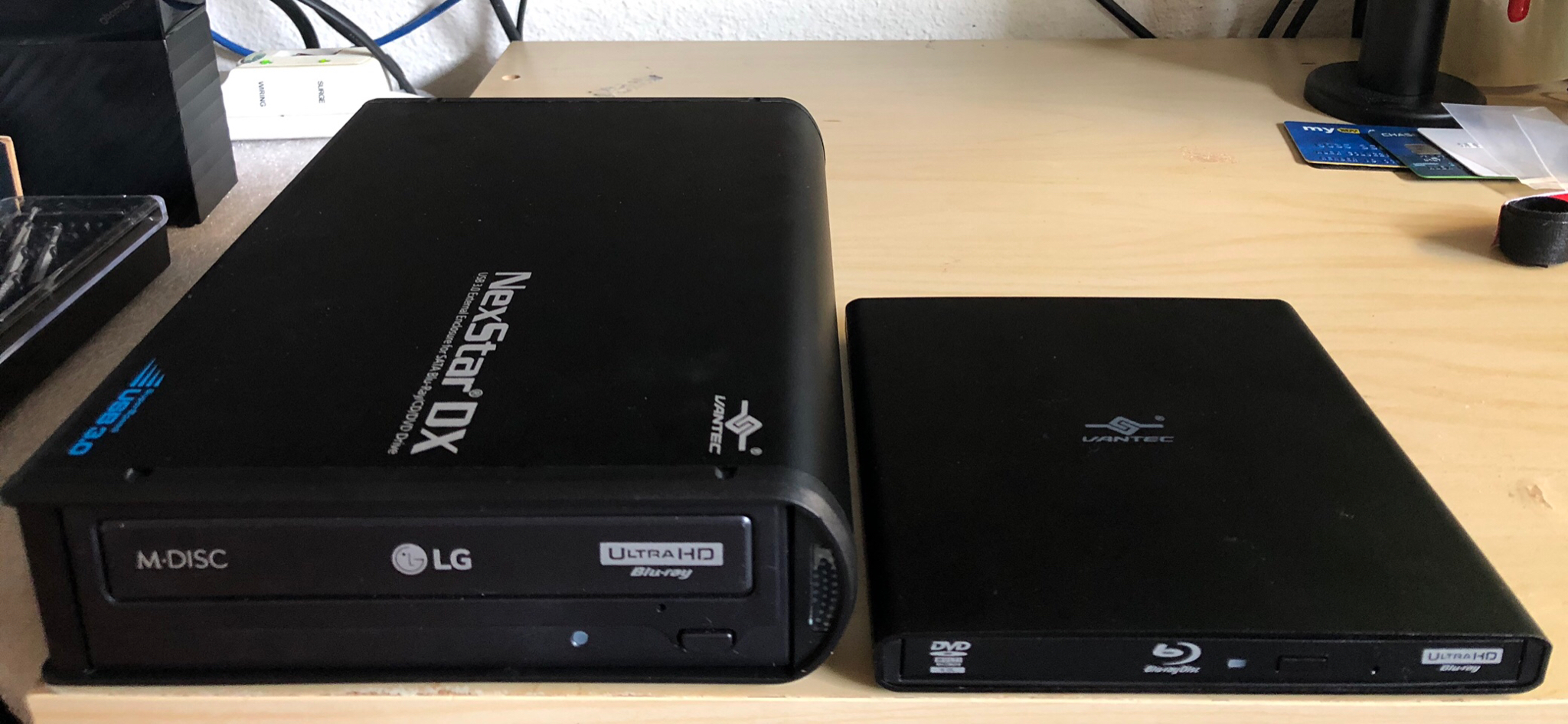

Update: slim drives are happening! BU40Ns get them here.IMG_1683.jpg
Ask me for a 4K “UHD Friendly” Blu Ray drive to try before you buy!
So it works?
So it works?
Also what speed are you it perform compared to a driver like wh14ns40 and wh16ns40
the BU40N with this firmware goes up to 6.0X and stays there, pegged, it's like it want's to go faster but something is throttling it back, it' s wild, even between files it's still chugging along at 6x. These little things are badass.
