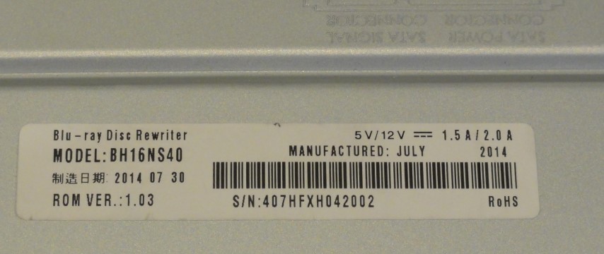

i try to read UHD Disk with MakeMKV Version V1.10.08 but it don´t work (no disk insert)
Laufwerksinformation
OS-Gerätename: F:
Produzent: HL-DT-ST
Produkt: BD-RE BH16NS40
Revision: 1.03
Firmware-Datum: 2114-03-26 11:15:
Markierungen der Bus-Verschlüsselung: 17
Highest AACS version: 63
BH16NS40 (Small).jpg (75.44 KiB) Viewed 44545 times
Is it possible with this Version ( SW and HW ) to get it work?

PauleFoul, neither of us has the NS50 version of the drive, so I think we are out of luck on that. I hate it when manufacturers use the same model number for incompatible versions of the hardware. :roll:

Woodstock wrote:PauleFoul, neither of us has the NS50 version of the drive, so I think we are out of luck on that. I hate it when manufacturers use the same model number for incompatible versions of the hardware. :roll:
Means it is important for these both models
- LG WH16NS40
- LG BH16NS40
to have the NS50 Version?
And what is with the Asus BW-16D1HT? Also has such HW Versions or is there only the Firmware-Version important?

I think at least 3 members purchased the ASUS BW-16D1HT so far (including myself) and it seems to be a great choice.
I didn't even install any drivers other than Windows recognizing it as a drive (the machine I use isn't connected to the internet), I simply plugged it in and the latest MakeMKV recognized it.
The manufacture date of the drive I got was December 2016.
My ASUS BW-16D1HT drive also has the following code written on it: KCC-REM-LGE-DMBH16NS40

I have 2 WH16NS40s both are on firmware ver. 1.02. Neither of them will read a UHD disk :( . Windows will not recognize the discs, I put a disk in and windows tells me nothing is in the drive. What firmware version are others on? It's possible i upgraded from 1.01 and broke something. I don't remember.
Posts: 10925
Re: UHD drives
With the LG drives, it is apparently VERY important that it have the "SVC code: NS50" mark on the label. If it isn't there, the drive won't read BDXL.
With the ASUS drives, the USB version doesn't do BDXL, but the internal ones do. I was going to disassemble the USB housing to see if the drive was the same as the internal, and the problem was JUST with the USB interface, but I elected to make it into a Christmas present instead, so someone with no interest in UHD.
I've got one of each on order right now. Amazon expects to be able to ship the ASUS "real soon now".
